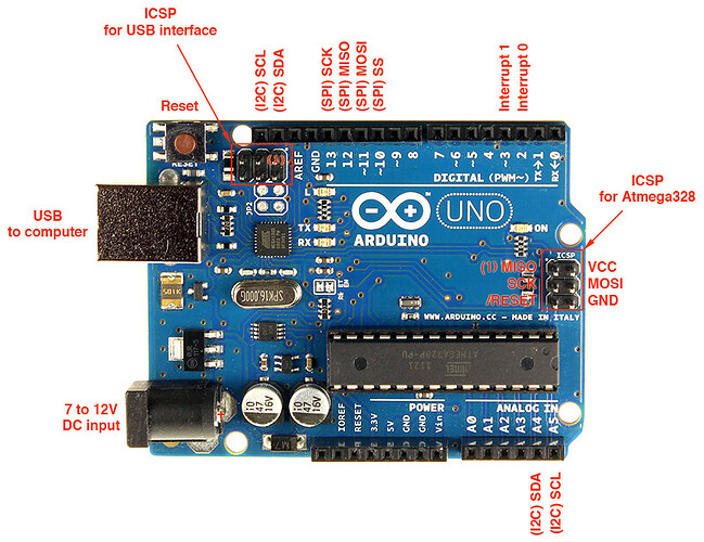

I can't seem to make the RTC DS3231 work.
SDA => A4
SCL => A5
I tried the I2C scanner and it didn't detect the RTC, although my RTC lights up. I tested the A4 and A5 pins, I wired some buttons to it and it worked, the serial monitor shows it when It's being pressed. I'm pretty sure I download the right and needed libraries, it lights up but it can't seem to be detected.

Don't try and move on until the scanner can detect the RTC
The first thing to check is that you have A$ and A5 connected the right way round to the RTC. Disconnect everything from the Uno, connect the RTC to A4 and A5 and run the scanner. If no device is detected then swap the connections to A4 and A5 even though you are sure that they are correct. Run the scanner again. Is the RTC detected ?
How exactly are you connecting the RTC to the Uno ? For instance, are you using a breadboard ?
If no device is detected either way then check the integrity of the connections between the Uno and the RTC. If you have a multimeter check that the jumper wires are intact

Have you tried a different set of jumper wires? Sometimes the wire will break inside the insulation, making it hard to notice.
Are you powering the RTC from 5V or 3.3V? Generally you would use 5V on an UNO.
I've also tried with different wires, in fact, that was the first thing that I did
Yes, I'm using 5V
I have also tried plugging it to the SCL and SDA dedicated slot, rather than the A4 and A5

The I2C scanner should be showing two devices, the DS3231 and the EEPROM chip that is on the board with the DS3231.
Have you tired with just the clock board connected to the UNO, no LCD or other wiring attached?
It is messy, and that makes it difficult to check the wires, but it looks to me like they are correctly connected. The red wire is SCL and brown wire is SDA.
I can't see where the black and white wires are connected.
I rearranged everything and it finally worked. It's weird cuz I already rearranged it. Thanks for the help
