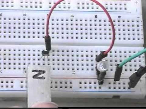

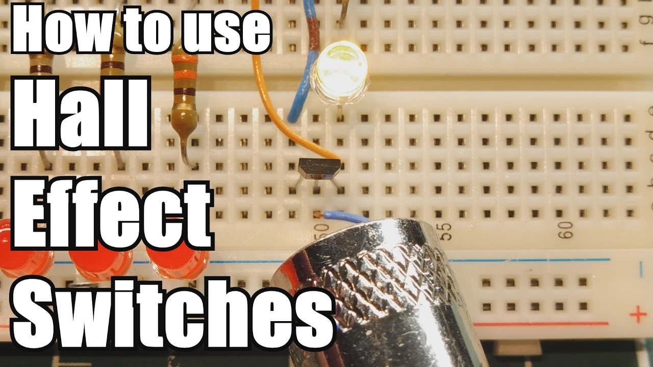

Highly suggest you look at 'Hall Effect Sensors'.
These are resistant to dirt/dust and ambient light does not get into the equation.
See
Looked at all the vids - It appears that the magnet needs to be pretty close!!!
Also looked closer at my IR sensor and it is made to go low, so I think it is wired right.
RayJorgensen:
Would depend on the strength of the magnet.
Your IR sensor has a range of only 1 inch.
You might what to design a mechanical linkage from your wheel to a cleaner environment where the sensor is installed.
A range of 1/2 inch would be fine. Dirt etc, might be an issue. I look more at the hall.

Shouldn't ( lastResetPBstate = digitalRead(IR_Switch):wink: be analogRead since it's hooked to pin A0?
I looked more at the hall switches and have some ordered. I agree they may be a better option due the the operating enviorment.

All makes sense. I'll wait a few days for the hall sensors. In the mean time I start on output to the 7 segment display.
Thanks
When you assemble the final setup, make sure the ‘Hall effect’ sensor gets close enough to the magnet.
i.e.
Let’s say the magnet and sensor starts detection at 1 & 1/2 inches.
It may be best to move the magnet to 3/4 inches from the sensor.
Some kind of debris guard (from stones, twigs etc.) for the sensor would be a good idea.
Note:
You can bias the sensor with a magnet and then detect ferrous objects.
You can monitor the wheel with a linkage mounted at an isolated clean location.
Note:
I'm not getting what you saying here.
See time unit @ ~5:14
