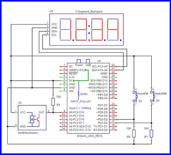

I got the Hall effect sensors late yesterday. I have it hooked up to a breadboard and it works as long as I put it to pin 2. My problem is I have a button hooked to pin 2. How would I change this to pin 4? Here's the test code:

Pin 2/3 can be used as interrupt pins, pin 4 cannot.
However, don't use interrupts.
Suggest you treat the 'Hall sensor' as you did the 'photo transistor', i.e. as a simple switch.
Then use the code I posted a while back.
I think you are using a UNO with external interrupts on pin 2 and 3. There are also pin change interrupts available on all the general I/O pins. I think that your options are
  1. use polling like larryd suggests
  2. Move the button to pin 4 and place the Hall sensor external interrupts on pin 2.
  3. Use a pin change interrupt on pin4. There is no simple IDE equivalent to attachInterrupt() for pin change interrupts. This means you are is best served with a pin change interrupt library unless you want to learn some of the lower level register commands required to implement the pin change interrupts.
There are several pin change interrupt libraries available and I like the one from Nico Hood in that the syntax is complely analagous to what you have learned with attachInterrupt(). It is available through the library manager, and there is additional documentation available at GitHub - NicoHood/PinChangeInterrupt: A simple & compact PinChangeInterrupt library for Arduino
attachPCINT(digitalPinToPCINT(4), magnet_detect, RISING);
I hope you are using two magnets. If not, change the half_revolutions to something which reflects the actual numbe of magnets you are using.
Remove the serial printing from the magnet_detect ISR. Serial printing requires interrupts, and they are disabled within the ISR.
Check the pin out for your particular part number.
Ok, that is easy enough. I just change the buttons to 4 & 5. That will leave 2 for this one and 3 for another should I need it.
Thanks
This project is dealing with slow devices, don't use interrupts.

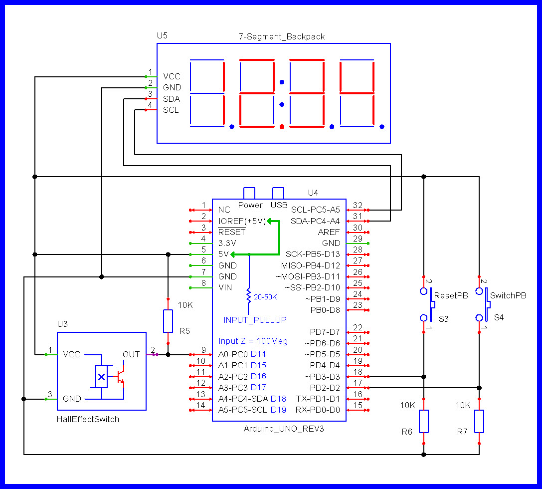

Larry, you just answered my next question with your diagram. (as as I was getting the soldering iron out.)
Don't forget 4.7k pullup resistors on SDA, SCL if the display lacks them.
Display seems to be working fine.
