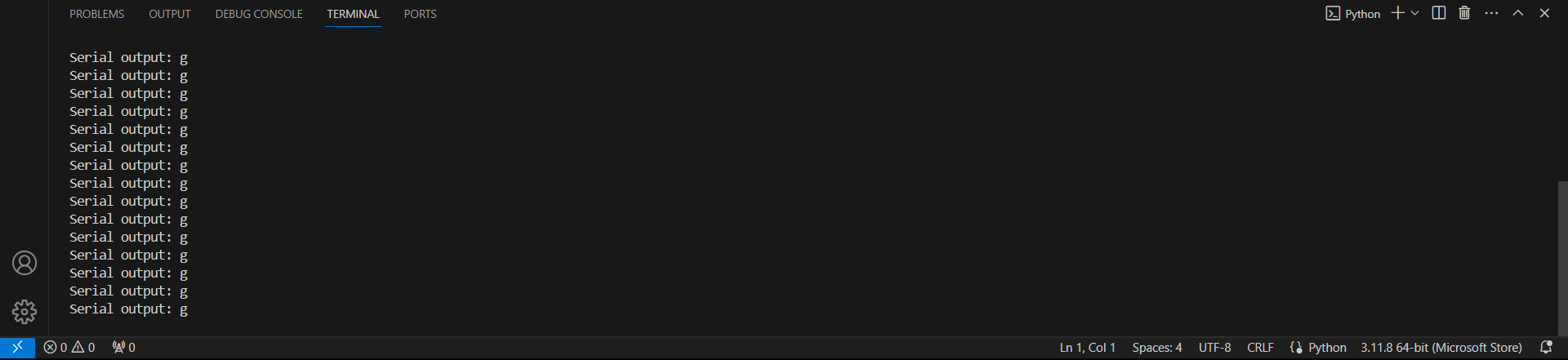

This code is not working properly because the output from Open CV program is sent continuously if an object’s color is identified as follows.

Wait for open CV to report "no colour" before aloowing counting. Somehow You need to know that there's a new object scanned.

Thank you so much. This is working
