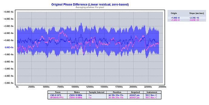

Following up, and thanks for all the replies!
After checking with my collaborator, we have an overflow issue, but not quite as I described. We are grabbing an interrupt and incrementing a uint64_t counter variable every 100us. That would give 58 million years as has been noted.
However the calculations are actually done on integer picoseconds. So we have to multiply the counter value by 1e8, add/subtract a value generated by external hardware in the integer range of 0 to 1e8 ps, and then stick a decimal point 12 digits from the right to yield XXXXXXXXX.YYYYYYYYYYYY seconds, which is output via USB to the host.
Because of that 1e8 multiplication, the overflow is hit at ~213 days, but that's in the calculation loop, not the counter. So the value of the counter is indeed good for 58 million years. We should be able to deal with the 213 day limit in the calculations outside the ISR, and thus I didn't need to ask my original question :-/ .
Some further info based on questions you've asked, or I suspect might ask:
  1. The interrupt is precisely every 100us; the source is a high stability frequency reference with digital divider.
  2. The measurement rate is fairly low -- often once per second. The measurement loop currently takes about 1.2ms, subject to some optimization. So I'm saying that the system is capable of >500 measurements/second.
  3. Yes, the attached hardware has meaningful results at the picosecond level: ~60ps resolution, and jitter about the same. However, its maximum measurement range is only a few microseconds, so it is combined with the 100us counter to generate timestamps over a longer range.
  4. Yes, picosecond-resolution measurements over a year or more is a real thing -- this system is designed to compare high-stability clocks like Cesium frequency standards where stability is measured in nanoseconds per year.
  5. The system works. We're generating solid results now with measurements spanning days, but still working to optimize. I'm attaching a couple of plots showing the results of one set of measurements.
Thanks again for all the input! While my question may have been unnecessary, I appreciate the conversation it generated.
