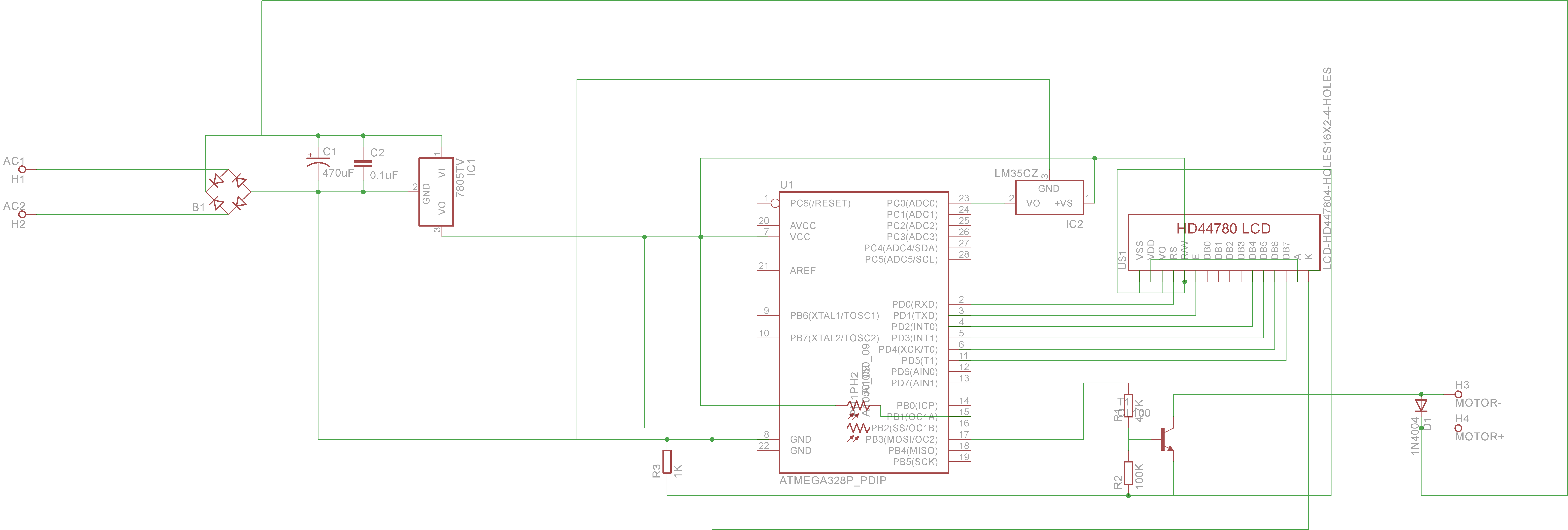

I have designed my PCB and fabricated it and don't want to spend time creating another one as i mistakenly used hardware interrupt pins as I/O for LCD.
EDIT : I am using standalone ATMEGA328( not 328p) with internal 8MHz oscillator, programmed via ArduinoToBreadboard example and tinkering.
Here is the code , eagle schematic and PCB .

ammar123:
Just as well and not a "mistake", as interrupts are virtually useless for this sort of application.
LDRs will work just fine as sensors, you just have to use the correct pull-up value (the internal pull-ups will likely work quite OK) and they must be mounted inside a long (4 cm) black tunnel.
The logic is a little more complex. If LDR1 is broken, then LDR2, then LDR1 is illuminated again, then LDR2 is illuminated, only then is the count incremented. All other patterns do not count. Correspondingly if LDR2 is broken first and LDR1 re-illuminated last, then the count is decremented.

Thank you for that little idea to increase counter. But i want to know how i can use LDR on digital PIN . ( as LDR would not give 1 or 0 output , which i realized later on.)
You can say i want to use LDR as a switch.
Please have look at schematics and please advice further.
ammar123:
An LDR acts as a variable resistor. You can connect one in series with a fixed resistor to act as a voltage divider, and connect the junction between them to a digital pin. The characteristics of the LDR together with the value of the fixed resistor would determine what light level caused the digital input to switch states, and you could adjust it by altering the value of the fixed resistor. This is quite a crude approach though - you would have much better control over the threshold if you connected the voltage divider to an analog input. If you choose the LDR characteristics correctly, you can even use the internal pull-up resistor as the other half of the voltage divider, simplifying the external circuit.

Can anybody elaborate on this method?. How can i achieve this ? . The concept of using Transistor as a switch will work. But only if when in OFF stage it should not get over 2V, or else the pin will get HIGH.
ammar123:
Thank you for that little idea to increase counter. But I want to know how i can use LDR on digital PIN . ( as LDR would not give 1 or 0 output , which I realised later on.)
There is no problem and absolutely no need to use analog inputs or analog input functions - you only ever want a zero or one input.
You just do as I described; you connect the LDR between the input pin and ground. You enable the internal pull-up function in the Arduino. When the LDR resistance is significantly lower than 10k (when illuminated), it will read LOW, if it is significantly higher, it will read HIGH.

You might want to add a filter cap on the output of the 7805. Your schematic is drawn a bit "funky". Don't have traces going through the parts and don't have parts inside other parts. Makes it difficult to read. I also think you missed the ground connection on the HD44780. Where is the trace off the right edge going to? What voltage is your AC coming in as? I'm assuming this is low-voltage AC, right?
Also, I don't see an external crystal, so I assume you are changing the fuse bits to use the internal oscillator? Not sure if that's automatic. I've always used an external crystal myself.
You're also missing a pullup resistor on the reset line. Without that, the chip will be stuck in reset mode. Also, how are you going to program the chip? Recommend you put in ICSP interface or at least breakout the RX/TX and reset pins so you can use a FTDI USB to serial interface to program an already boot-loaded chip. Question... have you actually tried this circuit out on a breadboard to prove it works? I'm guessing no, because there are a lot of things wrong with it. Breadboard it first before you design your PCB. Will help you figure out some mistakes.
I designed the PCB , It is working for sure.
and as far as programming for ATmega328 is i used ArduinoToBreadboard example. Tweaked the avrdude.conf to change the signature. and wrote the program using arduino as ISP . then upload the sketch Upload using programmer and yes i mentioned its running 8Mhz Internal oscillator.
THE PCB is PERFECTLY WORKING.
This was my first take at designing Eagle Sch and look closely for right edge line. It goes to +12V from cap ( for Fan) .
That's great that it works. I guess either you've set the RSTDISBL bit to disable reset on PC6 or you're just lucky with PC6 floating. I guess one way you could test that is to touch a wire between PC6 and GND for a few seconds and see if it resets. Since this pin isn't connected to anything, you have a floating pin. If you have not set the RSTDISBL bit, your chip could periodically reset itself. Heck, it might be doing that right now without you even realizing it depending on how your sketch works.

Thats what i am trying to do . with 2 LDR's and Laser beam to excite them.
But the problem is. I want to use LDR on digital pins i.e LDR as a switch.
are you still looking for a solution to this? useing the photo resistors on digital pins?
i suggested that you use transistors, keep in mind that transitors are current driven but this schematic may help you i left out all the values because im sure you want to figure it out yourself.
i mixed up the collectro and emitter, correction below
ammar123:
Yep, just connect each LDR between a pin and ground, enable the internal pullup (read instructions for this as necessary) and - away you go!
Couldn't get easier!
