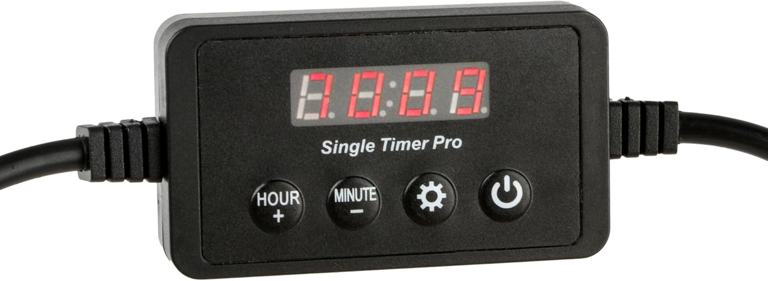

I see cheap LED dimmers for 12V LEDs on Amazon. Something like this. I wonder how they control the voltage?

Consider studying electricity and electronics. A short, two year program will teach you enough to safely detect AC, smooth puled DC, and regulate the DC output. You will need to do the work.
A "COB" is a "chip on board". Why are you trying to control voltage to a smart device?
Leds are current controlled.
So the COB or the amazon thingy will be a current controller...
For power led that is usually done with a mosfet and an inductor controlled with pwm.
Not really difficult, but if it runs from 220VAC it can be pretty dangerous to build yourself.

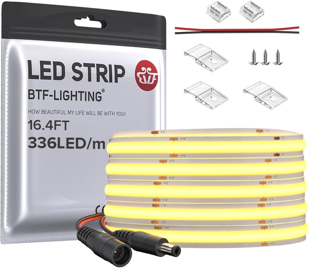

That doesn't mean much. Please post a link to the product page.
This is the LED. It's a 12V, but can be dimmed if you apply less than 12V, like 10.5V and up.
