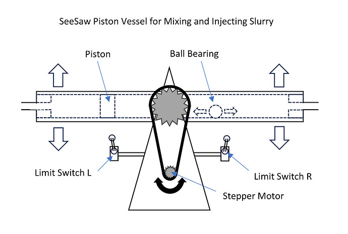

Hello everyone, I could do with some help.
I have designed a SeeSaw mechanism to tilt a piston driven injection vessel (basically a metre long syringe) from side to side. Inside the vessel is a ball bearing to mix the slurry inside it (a mixture of sand/xanthan gum/water) - this is a proven concept.
I am using a stepper motor to drive the SeeSaw with a limit switch on either side (see jpg). I am also using a potentiometer to change the speed of the stepper motor.
What I want to achieve:
  1. Stepper motor starts up slowly and moves CCW until the vessel activates the left limit switch and then moves CW until the switch deactivates. this will be home -> zero
  2. Stepper motor moves slowly CW until the vessel activates the right limit switch and then moves CCW until the switch deactivates. this will be the maximum position
  3. Stepper motor cycles CCW/CW between home +a couple of degrees/steps and maximum -a couple of degrees/steps . It should not activate the limit switches but SeeSaw the vessel between them just missing.
Once I have this working I would like to make the limit switches act as safety end stops, i.e. if they are activated the program/stepper motor stops and resets.
I would also like to add an on/off toggle switch to allow me to pause the program if possible without depowering the arduino.

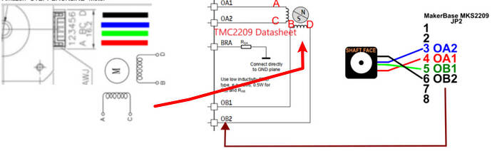

I have uploaded a diagram of the setup and a schematic of the wiring. Below is the code:

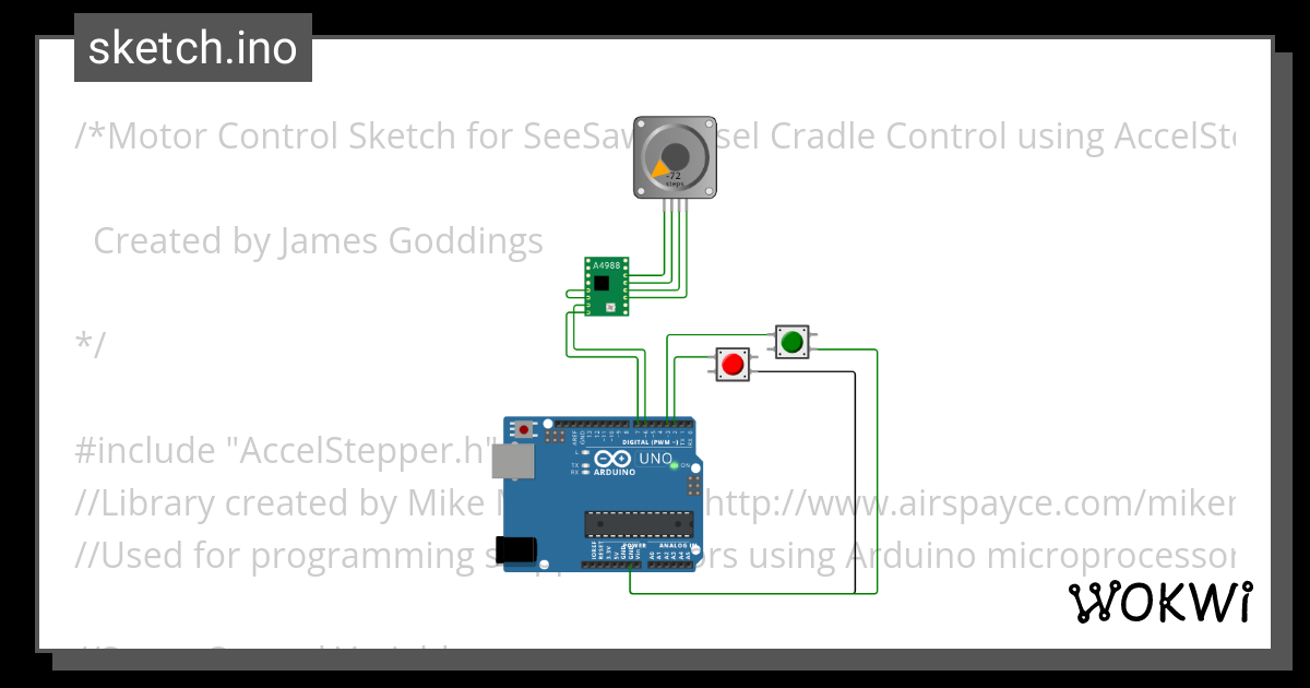

How long have you been working on this project? What progress have you made? Your skill is based on trial and error and learning. Did you just copy someone eases sketch, or did you design it your self and debug as you went?
What help do you want, as only you have the test setup?
There are certain things to clean up in loop() ...
If you look at these lines what do you expect to happen?
  stepperX.runToNewPosition(left_position);
  delay(50);
  stepperX.runToNewPosition(right_position);
Edit: You are commanding the stepper to go left and 50 ms later to go to the right ... See my post #5 for the reason that the stepper is quickly moving forward/backwards. It's because max_position is not set correctly ...
I'd think you shouldn't reset the current position after you've established the relation to limit_switch_l.
You merely need a measure of the number of steps between limit_switch_l to limit_switch_r.
Juddering sounds like a power or misspecification issue. Is your stepper up to the task and is the driver current properly tuned? Does your belt have slop/backlash?
There is also a glitch with the use of "max_position" ...
 stepperX.setCurrentPosition(max_position);//When the Switch is Activated Set This Position as Max Position for Now
The function setCurrentPosition() does not change the variable value of its parameter ...

See here https://wokwi.com/projects/390534148140979201
runToNewPosition is a blocking call, so the 50ms delay happens only after the stepper has reached left_position.
But because of the blocking call, the limit switches cannot be used as a safety end stop. A completely blocking free design is needed. Maybe this is easier to achieve with the MobaTools library.
BTW, 'real' safety endstops should never rely on software, but stop the movement by HW.

This is a suggestion to make your sketch work:
And here a sketch that does not use any blocking function and checks the limit switches to stop movement immediately when a limit switch has been triggered:
Sketch;
  Forum: https://forum.arduino.cc/t/creating-a-sketch-to-control-a-stepper-motor-with-limit-switches-to-drive-a-prototype-seesaw-piston-vessel/1227569/4
  Wokwi: https://wokwi.com/projects/390537630494628865

See on Wokwi: https://wokwi.com/projects/390537630494628865
There might still be some issues, e.g. if the tolerance to the limit switches is not sufficient.
Anyway, you might have a look at @MicroBahner 's MobaTools as they provide very helpful functions for servos, steppers, leds, timer functions and buttons! It's really worth it, Very well documented and lots of examples!
Good luck!

Many thanks to Edison and MicroBahner you have been an amazing help on this. I was not expecting such rapid and excellent responses, I have been looking for an excuse to get into microcontrollers more for a while, having only really dabbled before. It is great to find such dedicated and helpful contributors to the community. I am certainly going to start doing more projects like this so look forward to more.
To clear a few things up:
Very helpful comment, lead me to check the wiring of the stepper motor... The supplier sent the wrong data sheet and I had the wiring from the stepper driver to the motor wired incorrectly, double checked online and found correct data sheet with correct wiring (huh, the different colours do make a difference)!
Once I had the correct wiring it was a different ballgame and I may have got there eventually.
All of your comments were helpful and correct concerning blocking commands which I had gathered were an issue from videos on AccelStepper, but I was struggling to find a way around it.

To be tested on Wokwi: https://wokwi.com/projects/390626969872951297
Thanks to @MicroBahner for the efforts regarding the homing part!
Good luck!
ec2021

Here is a new sketch (on Wokwi https://wokwi.com/projects/391166823708089345) :
  Wokwi: https://wokwi.com/projects/391166823708089345
  Motor Control Sketch for SeeSaw Vessel Cradle Control using AccelStepper Library
  Created by James Goddings
  Combining the improvements of MicroBahner
  from https://wokwi.com/projects/390537977584839681
  and ec2021
  from https://wokwi.com/projects/390537630494628865
  In addition
    Removed unused variables
    Removed unnecessary function
    Added stepperX.stop() in case of limit switch activated in loop()
    Debounced the limit switches using a simple class
    Added printing whether the left of right limit switch was activated
    Added lots of comments ...
  Changes done 2024/02/24
  ec2021
  In addition
     Added the function pressed() to class SwitchType
     Added a toggle switch procedure to stop/start the movement
     Changed from setSpeed to setMaxSpeed (not to influence acceleration/deacceleration)
     Added a function to change maxSpeed only if variable_speed has changed
     Corrected some comments
  Changes done 2024/03/01
  ec2021
