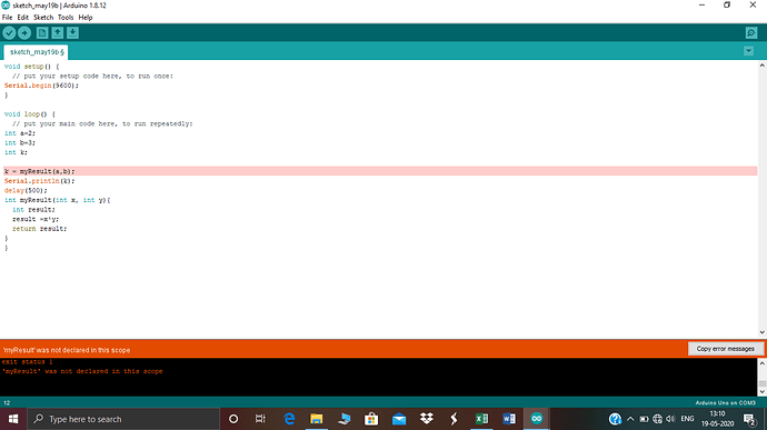

creating function
i am using an arduino uno and i am creating a simple multiplying project by creating new function but it shows error when i try to upload so can you pls help me with what am i doing wrong. i have attached the screenshot of my code below.

in C/C++, you can't define functions within a function
void loop (void) {
    myREsult (a, b);
int (myResult (int x, int y) {
