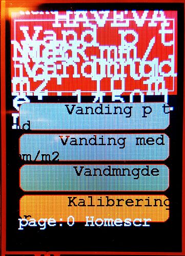

But there are a problem using them with Adafruit_GFX_Button.
The charsets referancepoint is lowleft, and with the 'initButton' function the chars is written to high in the button. And the 'initButton' don't know the width af the new chars.
See the attached picture.
So I have to use the standard 5x7 charset or give the 'initButton' an empty string and then write the text in the button later.

Well, the Adafruit_GFX_Button class is intended for the 5x7 font. The code is public. You can update it for other font formats.
I have no idea what all the gobbledygook means. Remember that the GFX "TextSize" is a global value. You need to reset it after you have drawn a Button. Or preferably before you draw your regular non-button text.
Yes, it would be wise for Adafruit_GFX_Button class to reset it automatically.

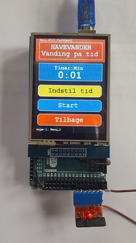

Hi David.
I have a sketch, where the menusystem work OK, but some computed values is not yet OK.
It use a lot of buttoms, whitch can bee reduced, it will be done later!
I will make some komment in the sketch before I attach it.

I has used extender font often and also use them in my project.
Maybe the best answer is to send you the program as it is for the moment.
I tryed you program buttom_multible, it compile and show two buttons and no else happen.
Menu_MCU1_GB.zip (11.7 KB)
