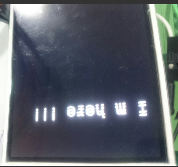

I use adafruit gfx library and i have some problem with fonts.
when i chose some font like FreeMono18pt7b i get double text on my tft .
ON this link is photo of my tft
this is part of my code .
tft.setCursor(15,100);
tft.setTextColor(WHITE);
tft.setFont(&FreeMono18pt7b);
tft.setTextSize(1);
tft.print("I m here !!!");
with default font its ok .
Have someone solution for this problem

i use adafruit and ili9488 library i dont ue mcu library
Well, I don't have an SPI ILI9488.
I built your program for an ILI9341 using "Adafruit_ILI9341.h" library.
Sure enough, it draws the text twice.
I re-built with my own "ILI9341_kbv.h" library.
It draws the text twice.
It seems rather odd. Especially since MCUFRIEND_kbv uses Adafruit_GFX and works fine.
David.

Ah-ha. I have cracked it.
Your program is continually executing loop().
First time. It sets the Cursor and draws "I m here !!!" correctly.
Second time. It sets the Cursor about 4 pixels lower. And draws "I m here !!!" in the second position.
So it looks like a problem with setCursor() in the Adafruit_GFX library.
I am surprised that this has never been noticed.
David.

What is/was the problem with Adafruit_GFX ?
Ah-ha. I see the solution:
    tft.setFont(&FreeMono18pt7b);  //call setFont()
    tft.setCursor(0, 200);         //before setCursor()
    tft.setTextSize(1);
