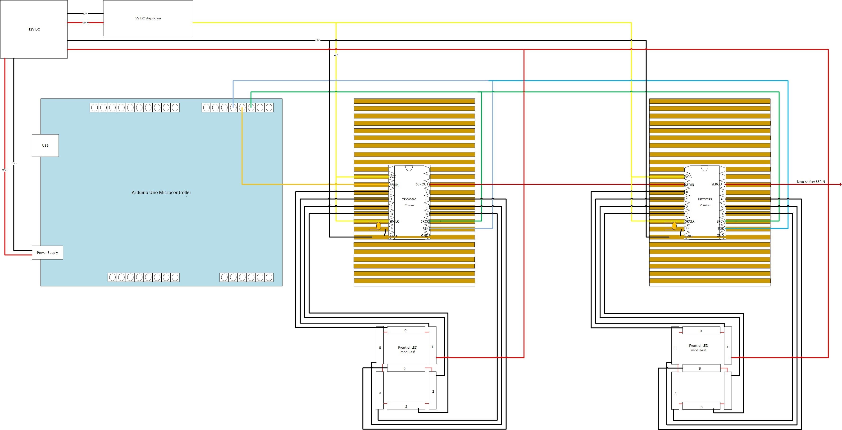

Hi.
I am building a new scoreboard from 12 volt LED Strips. I want to use an Arduino with a TPIC6B595 shift registrar and 3 buttons to move the score up/down and a 3rd to return them to zero. There are 3 units. A triple digit a double unit and a single unit. I can manage the hard wiring. Its the code I am struggling with. I have tried to follow tutorials but find it a bit beyond me. Can anyone help me with a very basic code to do what I want. Which is press a button to increase the score, press another to decrease the score and one to set them all back to zero. I what to do this project and learn more about coding so may be in the future I can make it wire less.

If that diagram makes sense to you then you are a better man than I (well, even if it doesn't) ![]()
Anyway, you say you need help with the code but you have not posted the program you are having trouble with. I don't see how I can help until you do so.
...R
I think a hand drawn circuit diagram with pin numbers and labels will be better.
Identify the cathode and anode of the LED strips and the size and type of power supply.
Thanks.. Tom.. ![]()
I still can't make out your circuit diagram clearly, but assuming that you have connected the TPIC6B595's correctly, you should start by seeing if you can make the numbers light up at all. Start simple and write out a bit stream that lights up one output at a time. Something like:

How much current is needed for each 12V strip?
What are the two power supplies?
Please a viewable circuit diagram.
Tom... ![]()

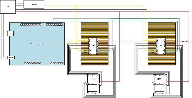

I have tried to upload the drawing but cannot find a way to attach to the post. If you know how to do it please explain and I will try again.
So one 0.5 metre strip is drawing 666mA. What length are you going to make each segment of the numbers?
The TPIC6B595 can sink 150mA per output, so a little over 10cm will be your limit plus you are limited by the breaks in the strip where there are contacts for cutting it.

If you use REPLY rather than QUICK REPLY and it has an attachment facility at the bottom of the screen.
12V 8W So 8/12= 0.66A, what is the current capability of the TPIC6B595 ?

The other thing I have in my circuit is decoupling capacitors as close to the shift registers as possible. I use a 4.7uF electrolytic (1 per board of three shift registers) and a 0.1uF ceramic (1 per shift register). You put the capacitor between 5V and GND, taking care with the electrolytic that you get it the right way round.
Hi Davidrh.
In my drawing there is a capacitor between 5v and ground, but I don't known where you mean for the other one. Could you read my drawing better now? I was looking at the spec for the shift register and may be I am wrong but it said 500ma per output. Do I have to write you sketch out or is there a way to copy it to my Ardunio
Eddie
If you check the datasheet it says "Eight Power DMOS Transistor Outputs of 150-mA Continuous Current" which is what I was going on. That is with all outputs on, which you will nearly have when you display the number 8 as it uses all seven segments.
I didn't notice the picture of a capacitor on your diagram ![]()
