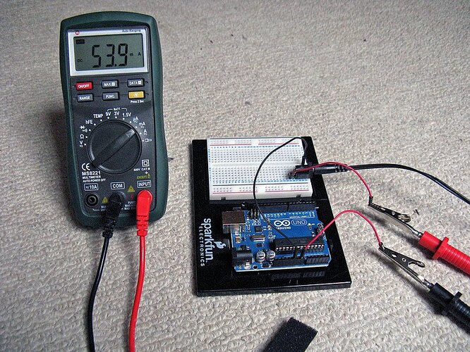

I'm trying to measure the current draw of my Arduino project, and I've found a link for it:
The theory behind is pretty simple, I just used a dc jack (as shown in the link attached) as an external supply. After that, I connected the multimeter in series to it.
However, I can't get any reading from multimeter as the Arduino wasn't even powered up when I connected my multimeter in such a way.
Is there anything that I've probably missed up? Or perhaps there's other better way to do the current draw measurement?
Many thanks for helping :slight_smile:

Show us an image of "your" setup.
Alright here you go :slight_smile:
The Arduino doesn't seem to be powered up when I connected in this way.
However, when I tried to replace the DVM connection with just a jumper wire, the Arduino starts working.
Looks ok.

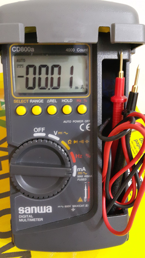

How about a image of the meter so we can see the controls and the jacks.
I still would give the likelihood to the fuse.
Does the red test point actually touch the metal in the proto board?
Same with the black?
As in the attachment, I've set my DVM to mA and DC mode.
And yes, I think it touches the metal in proto board.
I do tried to contact my probe directly to the dc jack (power pin) too, instead of measuring from the proto board. Unfortunately, it still seems to be not responding.
So you're saying that my DVM fuse might be broken ? :o

I got 1.5 mega ohm by measuring the fuse.
And for your information, my fuse rating is 0.5A/250V while the supply (dc adapter) rating is 12V 2A.
Is too much for the fuse to handle ?
The meter says right on the front "400mA max". So long as you are reasonably sure that your project doesn't draw more than 400mA then it doesn't matter what the power supply is capable of.
1.5M certainly seems to be a broken fuse.
