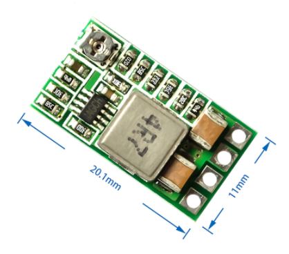

I have theese buck converters:
They are tested and good for arround 1.5-2 amp over long time. (Not the 3 amp they are rated for. Thats just rubbish) They are very small and with bended legs it have almost the same size as an LM7805 etc.
