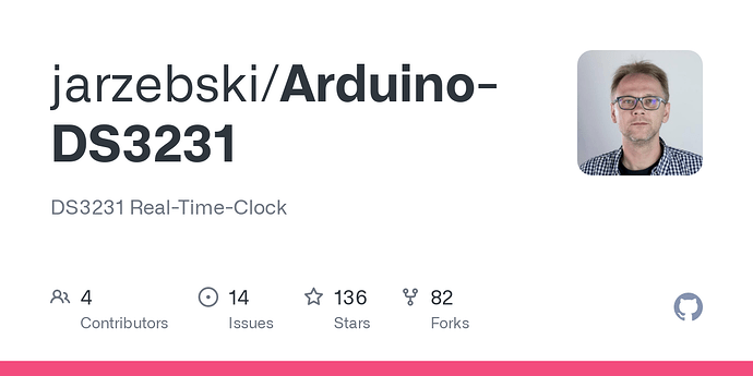

Please provide links the libraries you are using. There are several with the same name but different syntax.
@cattledog There are several with the same name but different syntax.
True that. This is the one I found that seems like a match, at least the code will compile where the library I had installed did not.
The OP’s code compiles. And as far as I can tell, functions correctly.
