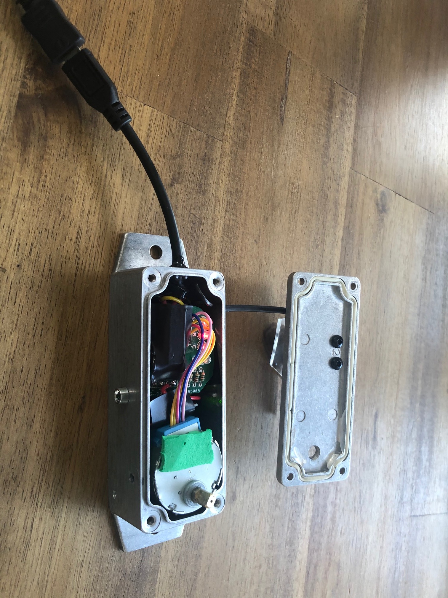

Greetings,
I have managed to create myself a waterproof panning camera mount from some scrap metal and a bearing from a fidget spinner. Photos attached.
My plan is to mount it on my balcony and have it rotate slowly throughout the day and have a gopro record sunrise and sunset in time lapse for the duration of lockdown...
I have been successful at defining the angle and time to perform the rotation from zero to defined angle but I want to ensure that the camera is always facing east(ish) for sunrise every morning and facing west(ish) for sunset. As the day length changes by a few minutes each day (gets shorter) I dont want to have the panning begin at the same each time day but rather a defined time about 30min beofre sunrise as outlined in the table here: Sunrise and sunset times Dunedin, New Zealand
So in anticipation i have included a DS1307 Real time clock but need some help implementing code
my thinking is that i need to store the sunrise times for the next X days into an array and compare the times to begin each days pan. the length of the pan would be defined in a second array.
i am not very good with arrays and using the RTC to make comparisons so i would really appreciate any help to get me started.
Below is the code that I have created so far and is working to move the stepper:
it allows modification of the time and angle and returns to home (limit switch) after each pan sequence.
any ideas and help to get me moving would be really appreciated!
Thanks in advance.
p.s. code will be in the next comment..
