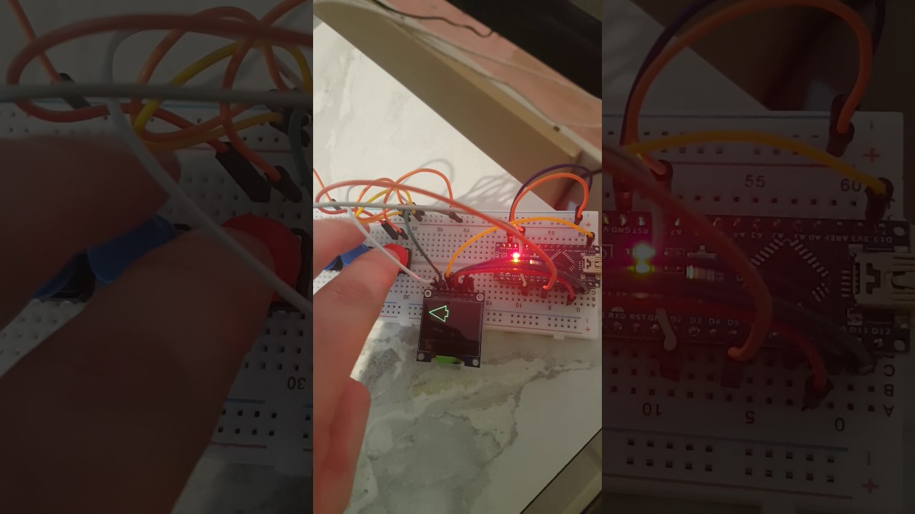

Hi guys.
Just decided to sign up and post my first question- I have been trawling the internet for answers for so long and frustrations are running high.
My project is an extremely basic one by your standards- I simply have a small OLED screen displaying icons depending on which input is closed. I have deliberately kept my code very basic- I realize it is not as tidy or professional as it could be however it does work well in its most basic form.
The issues come when I try using the drawBitmap function. I have attached the basic sketch and associated .c file.
Basically, REGARDLESS of the information i place in that graphics.c file I only get a garbled mess pixels on the screen. The command itself works fine- start position and color of the drawing are reflected in what i see on the screen but the actual image itself is the identical layout of pixel mess no matter what bmp data i give it... I can remove the image part of my .c file without any change to what i see on the screen after upload... As if its not re-flashing what i have already burnt into progmem?
I hope this makes sense- hate to be another one of those people probably not providing enough info so please let me know if i missed anything out.
more info:
NANO,
128x128 color oled display,
all libraries etc work well except when using the bitmap function.
Thanks for any help & greetings from New Zealand.
bmptestlatest.ino (547 Bytes)
graphics.c (7.65 KB)

I have tried the above however it fails to upload (compiles fine but has an error while uploading).
The wiring and stuff is good, I have had it working fine using the simple line command to draw the icons (however it gets pretty tiresome when you want to program icons which are more than 1 pixel wide lines)
Heres a video from a few weeks ago- I was pretty happy to even reach this point (i have changed to a larger screen since then, video was just to show a few people that i actually had something working)
If the code compiles then the only reason for an upload to fail would be a wiring problem, like it's not plugged in. Keep trying, or post the error message here. Use [ code ] tags for error messages too.
omg, embarrassing.
Yes, of course you are correct- i had recently unplugged the arduino cable from PC and plugged back into other port- had to change this in the software obviously.

The change to including this data inside the sketch has at least made me see varying patterns on the screen depending on bitmap content. Where as before the image mess never changed- now it does.
However now I am stuck with another issue. Using image2cpp to convert my little bitmap into code gives me garbage on the screen. Its acting as if i have the pixel widths messed up or the draw mode wrong but nothing I change gives a good result- just a different result (which is still closer than before where i got the same result every time regardless)
I have the pixel sizing of the image correct- I have checked that over and over. I have also tried changing the sketch width and height 1 pixel up and down in both vertical and horizontal incase there was an issue there- still no win.
I must be missing something really basic here.
Again- thanks so much for all your time.
SUCCESSSSSSS!!!!!
I ended up using the JAVA image to code program and that worked straight away :smiley:
Thanks so much for your help everyone :smiley:
