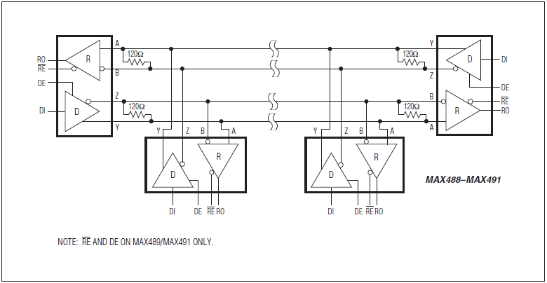

Just to muddy the waters slightly for you, there are 2 flavours of RS485. There's half duplex RS485 - where the same twisted pair is used to transfer data in both directions. And there is full duplex RS485.
This is an example of how half duplex RS485 is wired:
This is an example of how full duplex is wired:
Half duplex is what is mostly discussed here in the forum as most projects use a MAX485 chip.
The point to note is that you need some form of intelligent device to control the signals marked as /RE and DE to control the direction of flow of data.

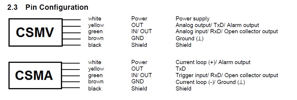

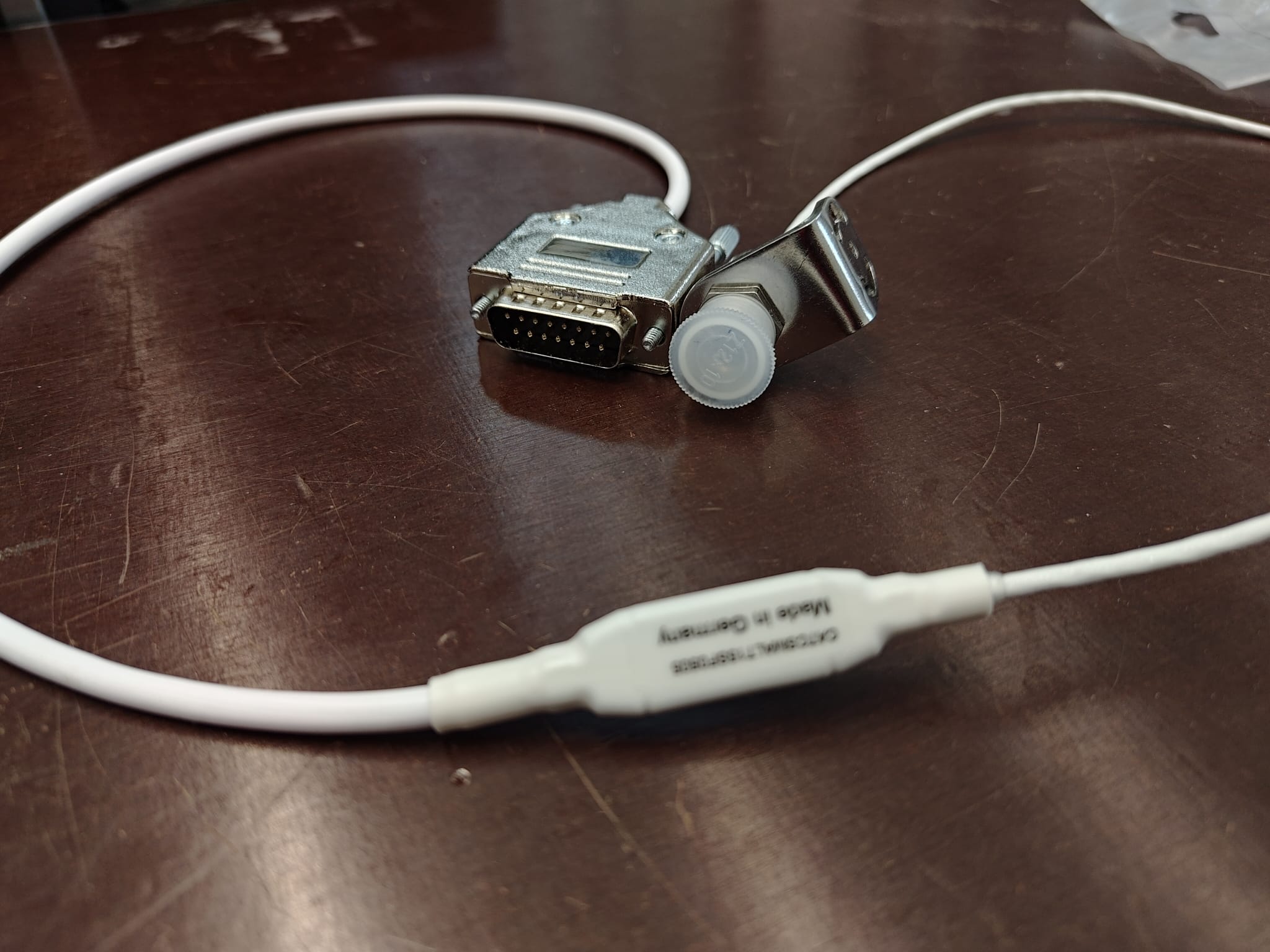

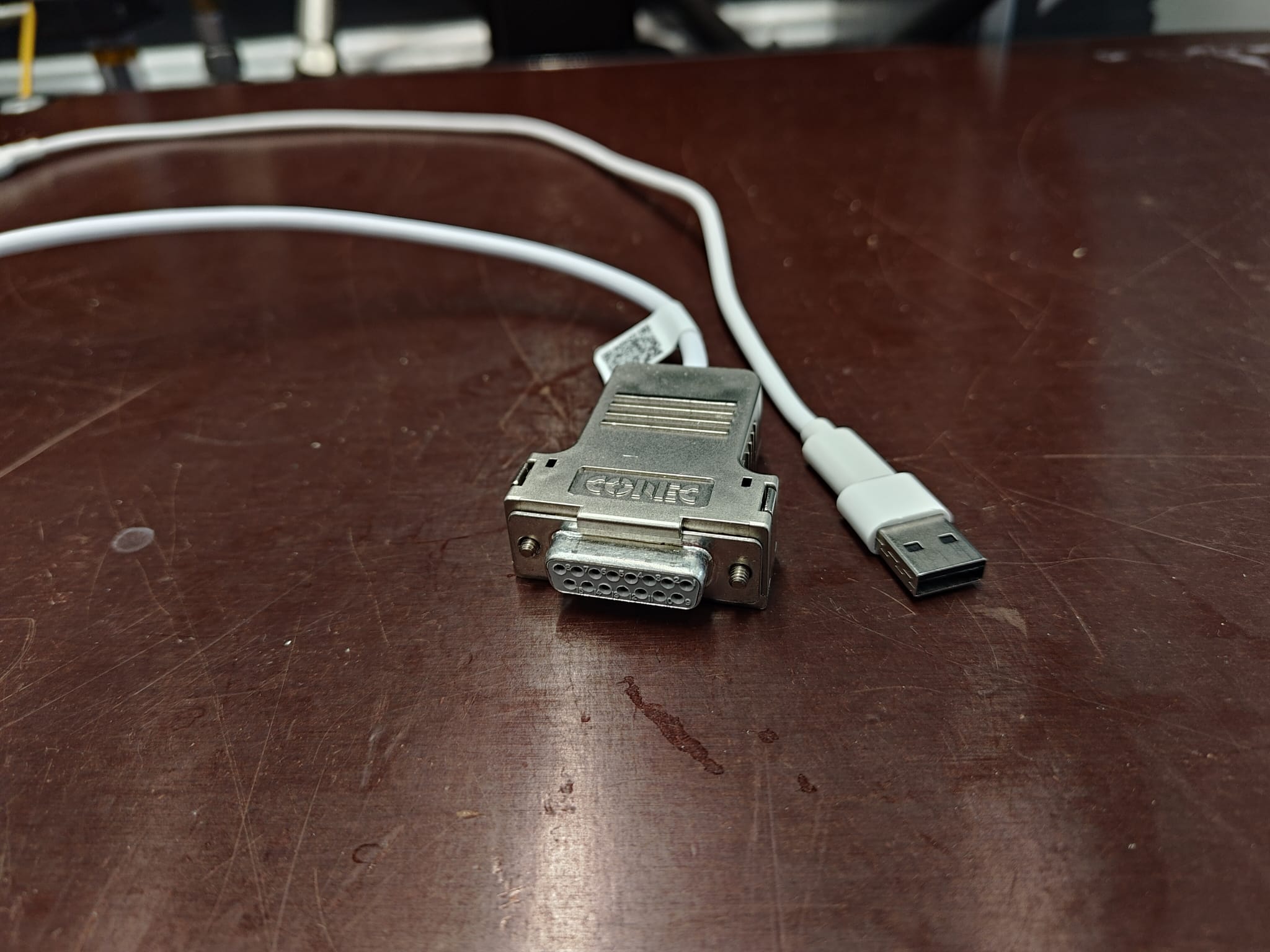

After discussing with my supervisor, he said that this pyrometer has a analog output signal in mA and there is an additional converter which to connect PC for communication. Here are some images of the pyrometer:

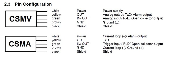

Following image is the pin configuration of the Pyrometer:

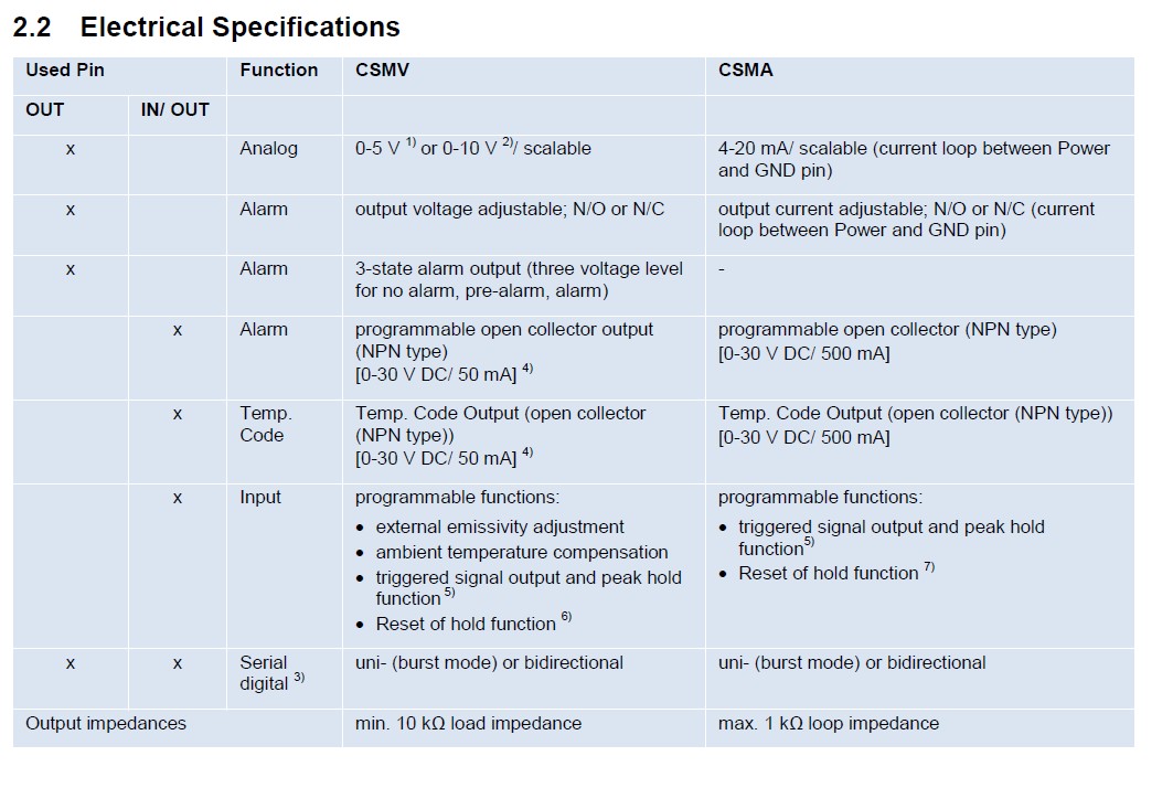

Could you please explain the working of this pyrometer and the output function (Is this Analog voltage / Ampere OR digital)?
Got it. Thank you for the clarification.
I will try to connect the sensor directly to MEGA2560 and try to read data. If this doesn't work, I'll change the controller maybe try PLC!
If it does not work then you did something wrong and using a PLC won't make a difference.
Do you know what pins are what on the 15 pin connector you show?
Actually, I'm not the one who connected this. I'll ask the electronic department and get back to you. Do you have any take on Output signal of this pyrometer.
CSmicro LT-Manual.pdf (1.6 MB)
There seems to be two different models that have different digital voltage levels.
Which do you have the CSMV or CSMA?
