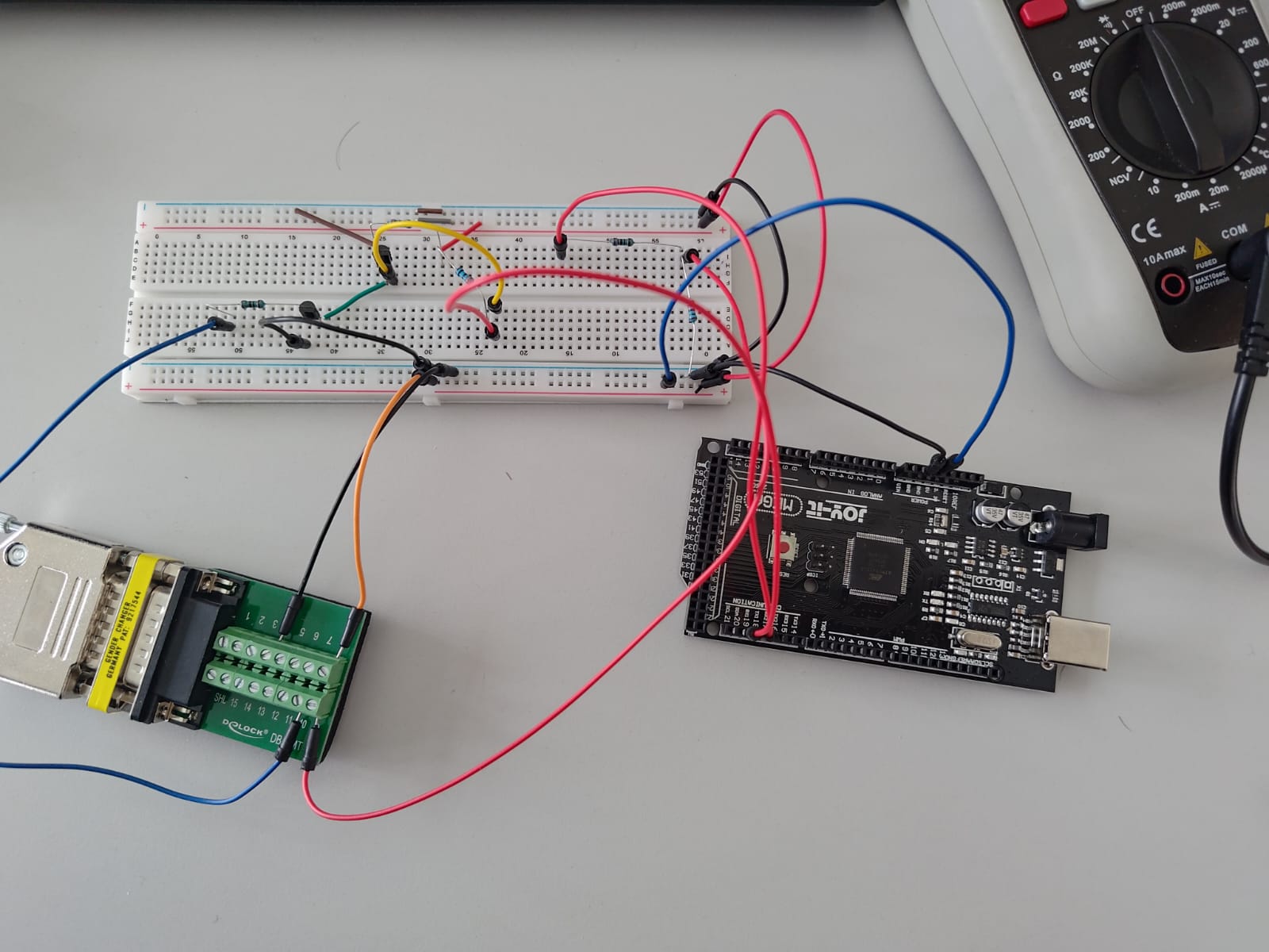

I can use a solderless breadboard, but in post #47, I didnt get th second connection for 2.5V
You said you have the CSMA model and according to post #40 and #44, the pyro Txd output is 2.5V, so that needs to be raised to 5V for the Mega.
I will connect everything to breadboard and upload here.
There are few changes from the diagram:
  1. R1 = 220 ohms
  2. R2 = 330 ohms
  3. Transistor = 2N2222
Here is the connection:
Do you have any suggestion for the code?

First just try to receive a byte on Serial1.
