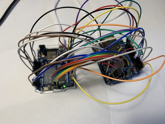

I tried an experiment. Instead of plugging the entire shield into the R4, I only connected 4 pins: IOref, GND, SCL, and SDA. The R4 is able to use the external RTC! So the conflict/interference is coming from some other pin(s).
Connected MISO, 5V, SCK, and MOSI through ICSP header and Pin 10. RTC still works and SD card is working. I continued to connect pins to see what the conflict was, but the RTC kept working! It is as if the UNO R4 is claustrophobic. If the shield is connected via jumper cables, the shield works, but if it is close to the R4 it doesn’t work. I thought the shield might be touching the ESP header pins and shorting them somehow. When the shield is mounted, it doesn’t touch the ESP header pins, but when I pulled up on the shield, so it wasn’t fully seated, the RTC and SD card work! Can anyone tell me how having the shield fully seated is a problem?
Adafruit says the problem might be intermittent connection due to skinny stacking header pins. I bought the stacking headers from them. Apparently, the “good ones” have 0.025” square pins. The pins I’m having trouble with are 0.015” thick by 0.025” wide. I read that some people tin the pins to get a better connection if they get stuck with skinny pins.

I think that is a reasonable hypothesis. I know exactly the sort of headers you are using, as I was unfortunate enough to obtain some myself, and they are indeed flimsy!
However, I would suggest you do a careful visual examination of your solder joints on the shield. It is possible the problem is caused by a low quality joint. This could result in there being an intermittent electrical continuity between the shield and the pin, which could be influenced by the pressures exerted on the solder joint depending on how far the shield is inserted into the UNO R4 WiFi.

Great suggestion. Some of my solder joints were marginal, but touching them up didn’t solve the problem. Tinning the SCL and SDA pins seems to make I2C communication with the RTC more reliable. The good news is that the shield is compatible with R4
