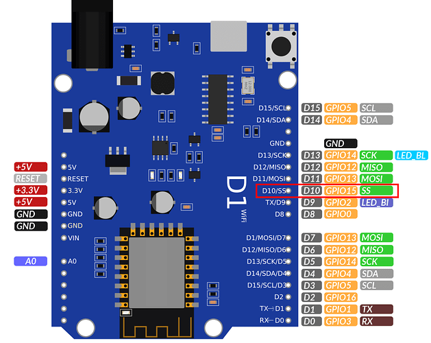

In this documentation Chip-Select ("SS") is IO-Pin 15 and not 16
so try
const int chipSelect = 15;

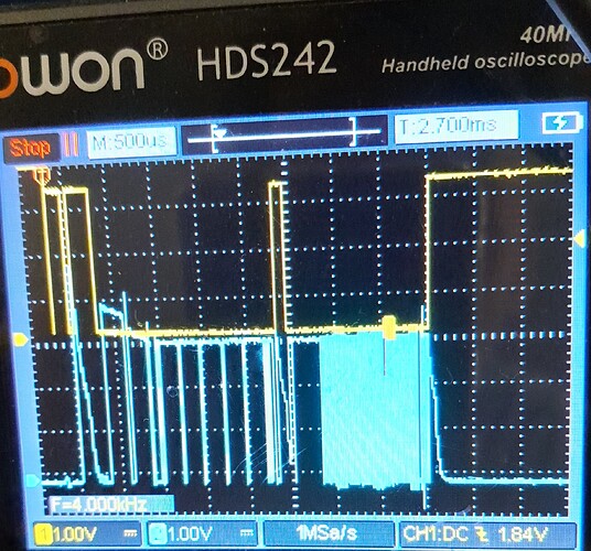

this is the CS (yellow) and the MISO. It only comes, if a card is inserted. The zhe data lines should be correct. Also the 3.3V level is ok.

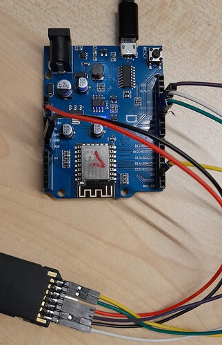

And here is my simple hardware setup.
I tried 2 different SD cards. Both work with the UNO board.

Did you noticed that the orighinal demo-codes use
GPIO-Pin 15

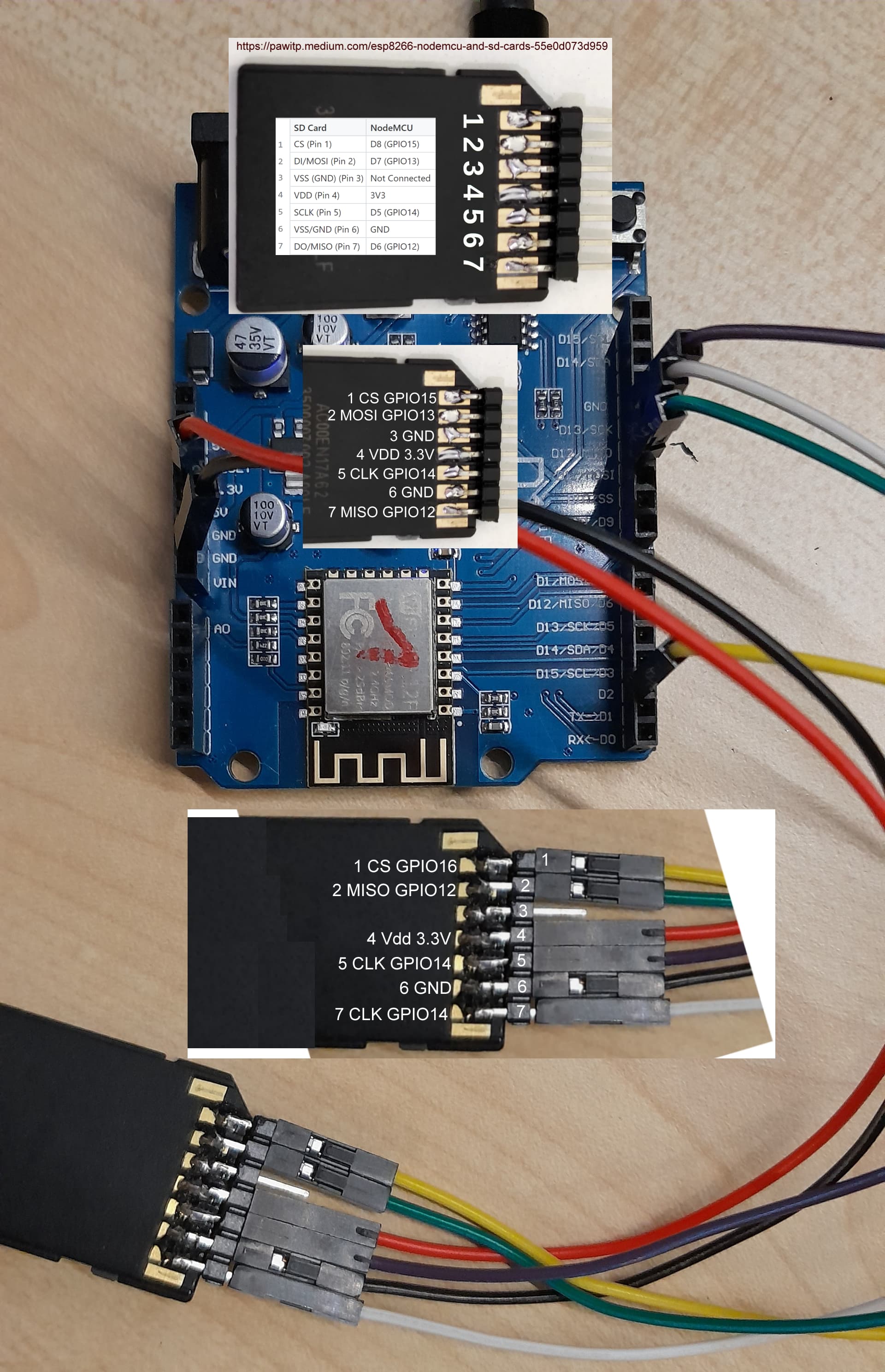

There are some more differencies between your wiring and how this tutorial wired it

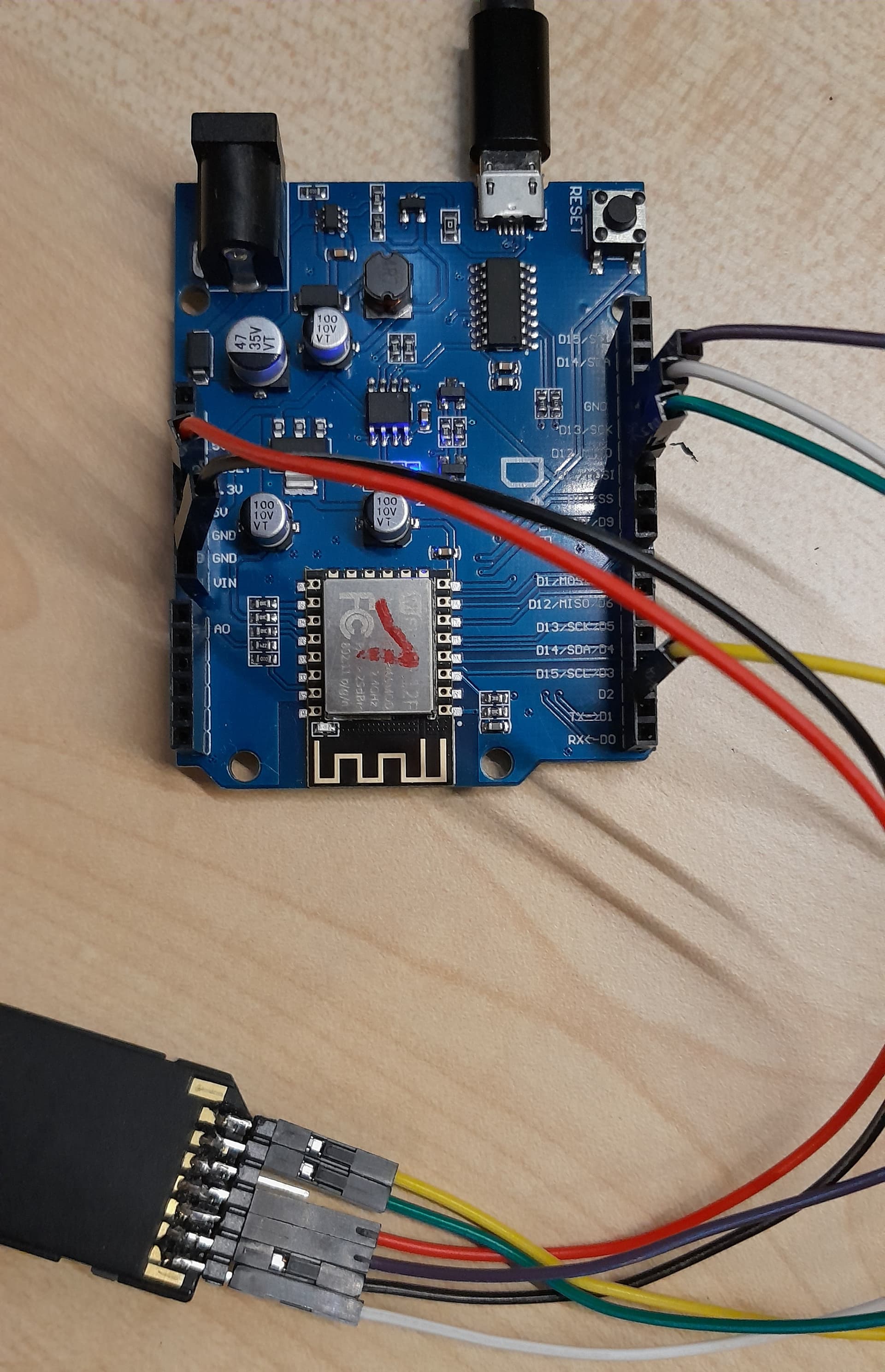

For my problem: I have exactly the same wiring as you proposed. But still "not present"
I did not really see what is connected to what because your picture is not taking from vertically above.
It took me a long time to verify this. In future I will allways ask for a picture from verticaly above before analysing anything
