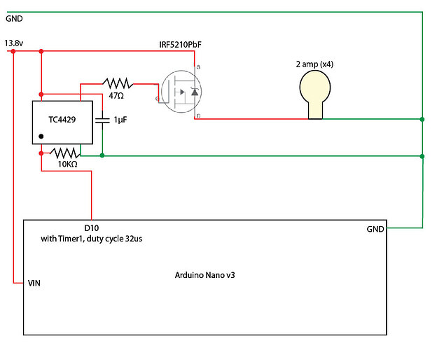

I am trying quickly to throw together a DC dimmer circuit for four two-amp bulbs in an automotive setting. I need to run the PWM at 30kHz to eliminate a horrible humming that these bulbs make. I have put together the following diagram showing all but the potentiometer that will be used as the human interface.
Could one of the experts review my circuit?
Thanks.

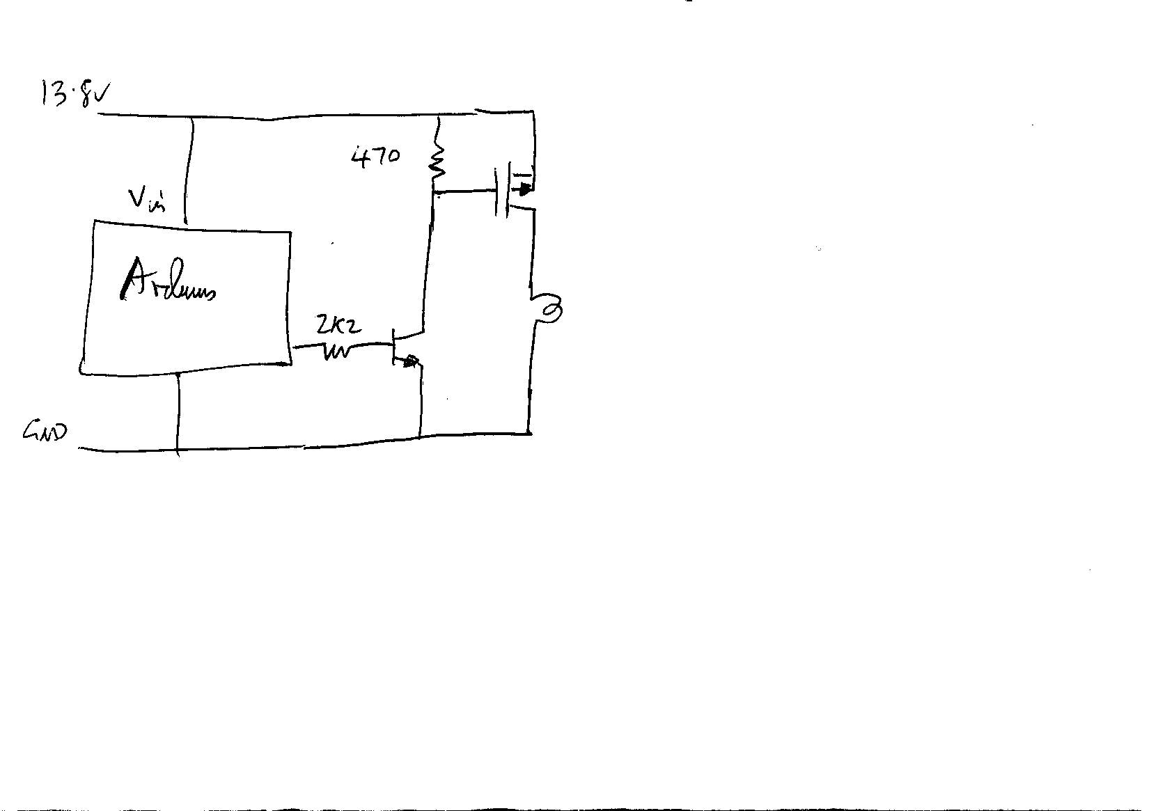

Why not do away with the SSR/IGBT combo and use an NPN transistor driving a P-channel mosfet instead? See attached.
When choosing the mosfet, bear in mind that the resistance of a filament bulb when cold is much lower then when it is hot, so the inrush current is correspondingly higher than the steady-state current - about 15x higher, maybe even more.
Running the Nano direct from 13.8v will not harm it, the main thing is to avoid drawing too much current from the +5v rail in order to avoid overheating the regulator.

I have revised my diagram to reflect the changes suggested:
That circuit isn’t quite right. Between the TC4429 output and the mosfet gate, use a single series resistor (I suggest 47 ohms) instead of the 2 resistors you have in that diagram. You could omit the resistor entirely, but then you would need to pay very close attention to circuit layout. Connect a decoupling capacitor of at least 0.1uF between the Vcc and ground pins of the TC4429. Keep the wiring between the Vcc pin and the source terminal of the mosfet short.
On the input side, connect the TC4429 input direct to Arduino D10, but also connect a 10K resistor between D10 and ground.
The 1k resistor can be reduced, indeed, but the 10k resistor is sensible - it stops the MOSFET gate floating when the Arduino is powered down.
MarkT: The 1k resistor can be reduced, indeed, but the 10k resistor is sensible - it stops the MOSFET gate floating when the Arduino is powered down.
If you are referring to the 10K resistor on the mosfet gate, it isn't needed, because the mosfet is driven from the TC4429, not the Arduino. Where you need the 10K pulldown is on the output of the Arduino, because the TC4429 has a mosfet input.
The 1K resistor MUST be reduced, after all the whole point of using a mosfet driver is to get increased gate drive to reduce the mosfet turn on and turn off times. With 1K, I estimate the turn on/turn off times will be in the region of 20 us.
MOSFET turn on (and off) time is determined by drive current (Ig) and MOSFET gate charge (Qg). Based on datasheet specifications for IRF5210, we can calculate drive current required for a target Ton (50ns) as follows:
Ig = Qg / Ton = 180nC / 50ns = 3.6A
Assuming a nominal voltage of 13.7, this dictates a total gate resistance as low as 3.8 ohm (13.7V / 3.6A). Output resistance for the TC4429 is specified as 2.5 Ohm and so the gate resistor should be 1.4 Ohm (3.8 – 2.5).
To get to 80ns (as quoted in the datasheet) and using TC4429/IRF5210, Rg should be 3.7 Ohm.

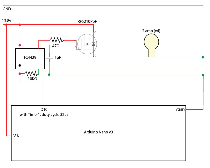

The circuit is now set up as in the attached diagram. However something is not quite right. For testing, I am running the circuit on 11.9 volts. When D10 is high the output from the TC4429 reads 11.65 volts on my multimeter and 11.9 when D10 is low. Obviously, that is not enough to turn the IRF5210 on.
May I once again appeal to the experts for some advice?
Thank you for your patience.
You have drawn the mosfet the wrong way round, however if you have wired it up according to the S G D labels in your schematic then you have wired it correctly.

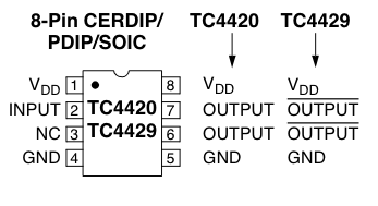

You haven't shown the pin numbers you used for the connections to the TC4429. Check these connections, in particular make sure you have connected both ground pins and both Vdd pins (the datasheet says this is required for proper operation of the device).
Hello dc42!

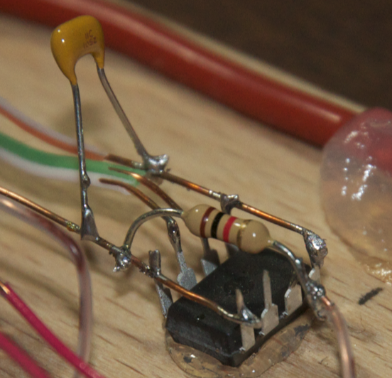

Well, I have quintuple checked the connections multiple times. (My brain has involuntarily been going over every little detail for hours)
I wired the IR5210 according to the datasheet where pins 1, 2, and 3, are G, D, and S, respectively. (See attached)
WRT the TC4429, I have all the pins connected except for 3 which is supposed to be left unconnected. The chip is mounted upside down on my circuit (again see attached), so the pin numbering is clockwise from the top-right.
Even now my gut feeling is that something is “misconnected,” but I can’t see anything wrong.
