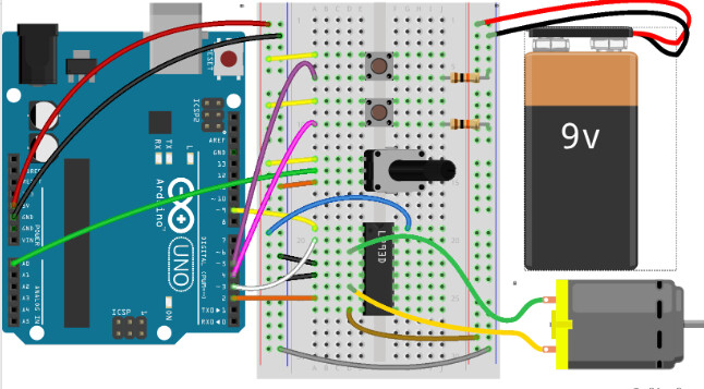

For a project I am doing, I have created a simple code using two push buttons and a potentiometer to control a DC motor, I wired the DC motor to an H-bridge and I know FOR SURE that my wiring is not the problem because I am using the same exact wiring diagram from project 10 of the Arduino uno start kit. My code should be very easy to use. Once uploaded, I should be able to hit "upPin" to turn the motor on in one direction for 3.5 seconds and when I hit the "downPin" it should go in the other direction for another 3.5 seconds. However, when I plug in the uno and upload the sketch, the loop IMMEDIATELY starts to run and doesn't wait for my pins, even though I set them up initially to LOW in the setup(). I have showed my professor, and he stated that my brackets were not in the correct spots for my IF statements. But when I move my IF brackets around any further, the motor doesn't run at all. He then suggested it has to do with the pins of the H-bridge but the circuit works perfectly fine for project 10 under FILES->EXAMPLES->STARTER KIT-> PROJECT TEN ZOETROPE so the way I am manipulating the pins in my own sketch shouldn't be what is causing my push buttons to not work. I just need help with understanding why my buttons are not being acknowledged and what I could do about it. The only reason I put the five second delays is because the motor will just keep running and keep switching directions if I didn't add some kind of pause in between the two.
