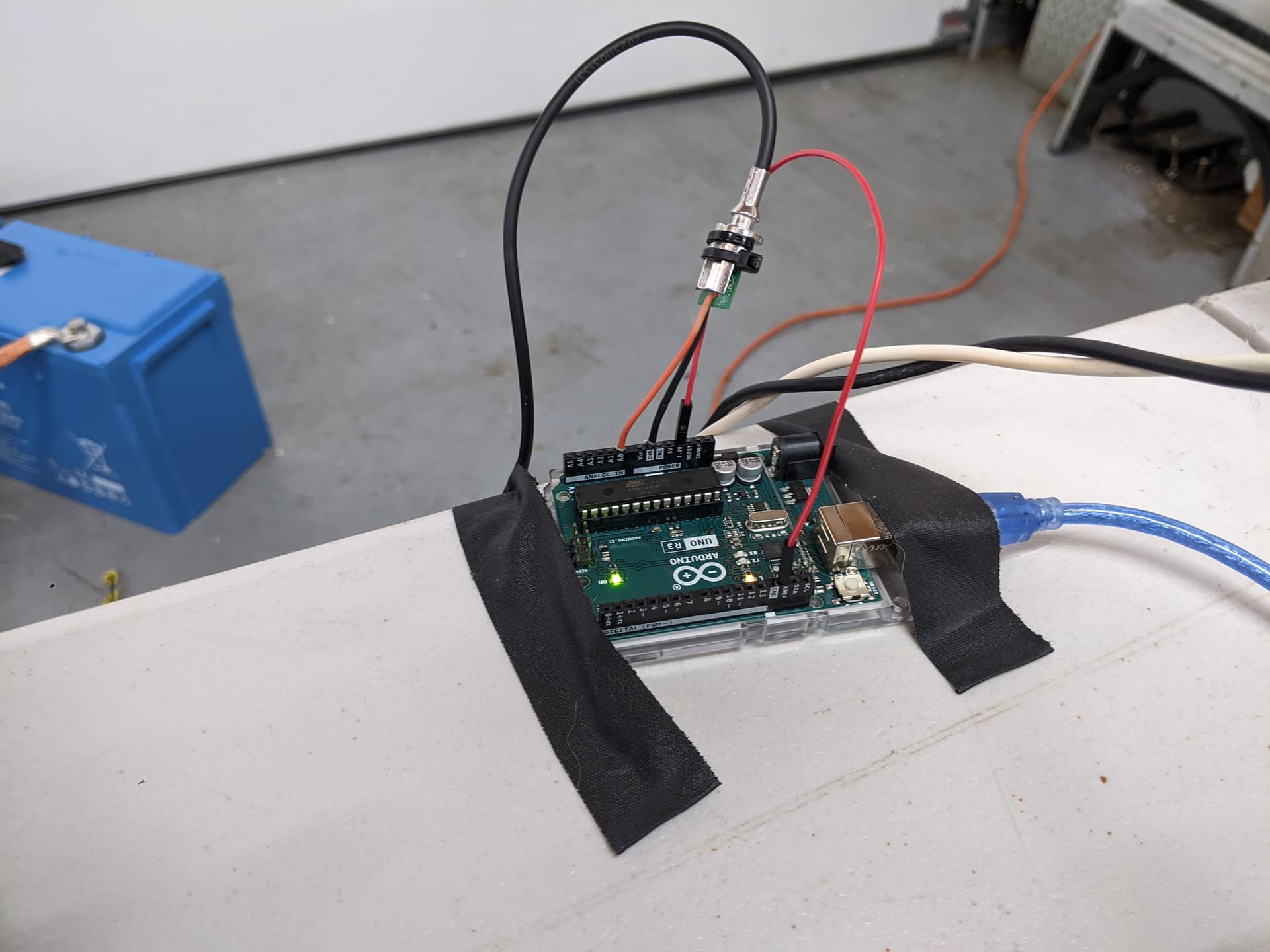

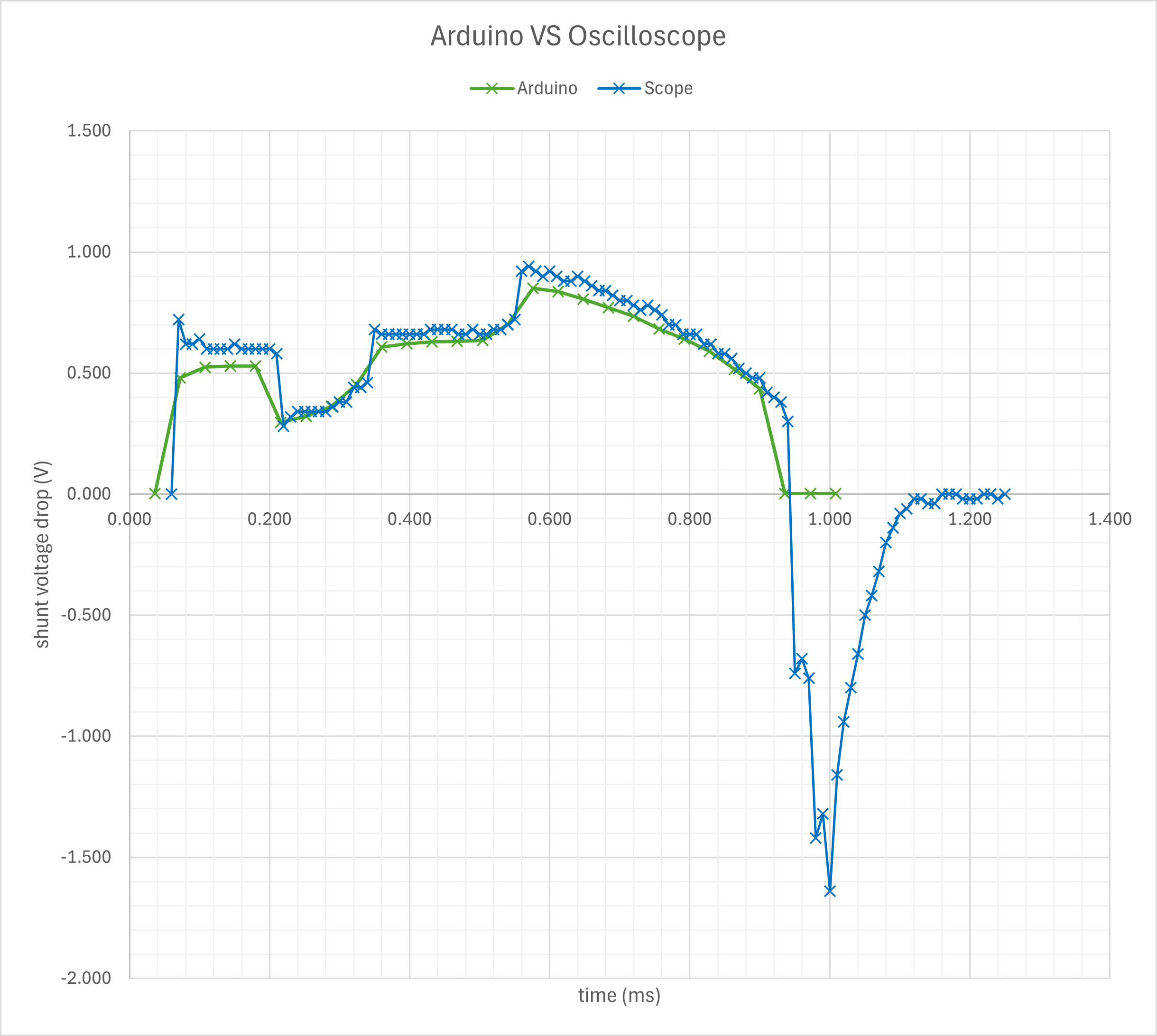

When comparing measurements of a given constant voltage of 700mV between Arduino (via analogread ADC), scope, and DMM, then the values are nicely within approx 1% of each other. However, when measuring an (aprox) 700mV voltage drop over a shunt caused by a battery DC dead short, then the voltage measured by the scope is roughly 200mV higher than the Arduino. Apparently, the change from a static voltage to a dynamic one changed something. The Question: What could be the reason for this and how to possibly correct this? Note that the "Waveform" of the short circuit current (or corresponding shunt voltage) matches well between Arduino and scope.
Context
This project. Edit: based on comments below (limitations to link access), more context here: The goal is to measure the dead-short-circuit current and fuse clearing time with an LFP battery.
Graph notes: I manually horizontally shifted the two curves to align them. Also, 1V corresponds to 10kA.

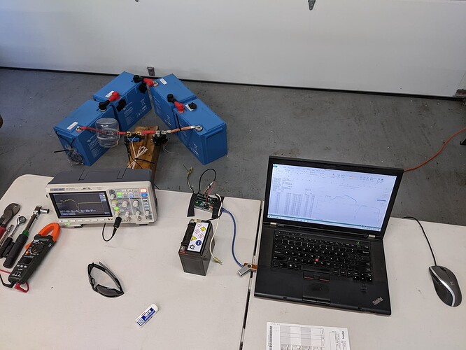

Hardware (with voltage accuracy):
  • Shunt: 500A 50mV Victon SmartShunt; Made of Manganin | has enough thermal mass to withstand the short, trust me.
  • Genuine Arduino UNO R3 with ATMEL ATMEGA328P. (ADC accuracy: 2 LSB); Calibrated reference voltage.
  • Oscilloscope: Siglent SDS1202X (DC Gain Accuracy for 5mV/div to 10V/div: ≤ +/-3%; offset accuracy for ≥2 mV/div: +/- (1%·Offset + 1.5%·8·V/div + 2mV); warmed up 30min; brand new.
  • DMM: Klein Tools CL380 (accuracy: 1% + 8 digits).
  • Probes (used for both scope and arduino): Siglent PP215 probes. The probes for Arduino and scope hook up at the same points on the shunt.
Code
Goal: Log the smartshunt current (using the voltage drop accross the shunt) during a DC dead short.
Event duration: Roughly a millisecond. The sampling interval should be at least an order smaller than that.
The code below uses "fast sampling" until the dynamic mem is full.

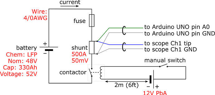

I would imagine that the difference is due to the way that you have wired up the test circuit.
That current shunt has a resistance of only 100µΩ, so it is extremely easy to add extra resistance into your wiring which could skew the results.
As you are measuring a changing voltage, then the inductance of the wiring also comes into play.

Why does the voltage (and current) change sign (and "charge" the battery) after the dead short according to the scope? Capacitative effects? Note that I was able to reproduce this current "backflow" with the arduino in a previous measurement, but in the plot I only plot positive currents for better resolution purposes.
How long does that continue? Do you think the heat from a short circuit just might change the cell chemistry for a short time?
I don't know, but applying -1.5V to an Arduino analog input will destroy it in short order. What are the time units on the horizontal axis of the posted plot?
Keep in mind that even short straight wires have inductance, and show ringing with sudden voltage transitions. There is plenty of capacitance in those long sensor leads. See
About a tenth of a microsecond. I do not know the cause. Looks like some built up charge can no longer flow from plus to minus, so it flows back.
microseconds (see also the plot in the OP).

Some simple things to verify, which you may already have 'put to bed', but I see no indication of it.
  1. you have a power connection on the computer - have you verified isolation between ground and your Arduino's GND, or do you have a sneak path, when considering the next question
  2. you have a power connection for the 'scope - have you verified isolation between ground and your scope GND...*
Significant current could be flowing not where expected, which could appear as a difference between the two measurements. Sneak parallel paths for high current flow can be tricky to identify, and sometimes only become evident when a smaller gauge wire disappears, or you smell smoke.
Again, you may have already investigated, and dismissed, the potential for a ground loop offset, but I offer it up as one possible explanation for your variance in measurement.

Thanks. I did not pay particular attention to grounding:
  • The Arduino GND is connected to the USB GND of the laptop as by default.
  • The laptop is not connected to the 120Vac mains ground as by default.
  • The Oscilloscope channels GND are connected to 120Vac mains ground as by default.
So the Arduino GND does not connect to the scope GND through the 120Vac mains GND, if that is what you mean, so I do not see a ground loop there. I verified this with a DMM.
Do you recommend a USB isolator?
