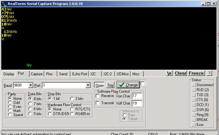

Look at the picture between the 10 and 13, I'm actualy printing the byte of the char, and there is that nothing that print along, what is it?

What can I do? I was counting on the double to know that my string is in, but that blank line screw me up. lol
Try changing your line ending to Newline in your Serial Monitor. There are some other configuration options you can play with there also
I don't really care about what it display in the monitor, the problem is that my code does not recognize the character so the double series is not recognize eider.
I'm basically sending a AT command to a wifi module, and I'm working on getting the answer.
Never mind it send a double linefeed it seem according to Realterm
For testing send the bytes to the serial monitor as HEX characters all on one line with
Serial.print((byte)caractere_entrant, HEX);
Serial.print(" -- ");
This will rule out the possibility of the serial monitor doing funny things when it gets a Cr or Lf.
...R
