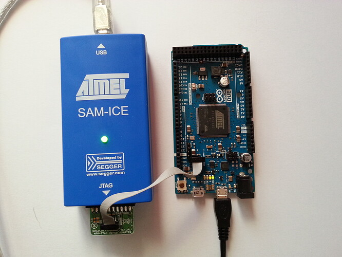

I got today my SAM-ICE JTAG. I debugged a couple of solutions in SAM3X-EK and it's working OK. I still thinking to use SAMICE with Arduino Due for debugging. I have drawn the following connection diagram between Arduino Due Jtag and SAM-ICE JTAG theoretically based on SAM3X-EK design and other reference information. I haven't tested it yet but it looks like should work. The hard thing has been to find the way to interconnect them. In the meantime, I have modified a mini-sata conectors. I will keep posting progress in my attemp to start debugging Due.
Does this do the same thing ARM-JTAG-20-10 http://microcontrollershop.com/product_info.php?products_id=4650 I haven't checked out the wiring - but there is an ARM spec for a 0.05" connector.
Good catch neil. It should work but we need to see the schematics. I could order it today and try it. The cable I made has false contacts and is hard to keep the communication. If you want to risk the $7 bucks, keep me posted!

I used the latest version of Atmel Studio 6, ARM-JTAG-20-10 from Olimex converting the jtag interface and the debugger SAM-ICE from Atmel. Atmel added the Arduino Board to Atmel Studio 6 IDE, so it is very easy to set up a project for due. For testing I wrote a small example which toggles the on board LED. Result: Stepping through code works great.

So the toolchain is DUEX powered externally with 9volts, DUE JTAG connector (10pin 0.05") – cable ARM-JTAG-10-10 --(20pin 0.1") Atmel SAM-ICE JTAG emulator to USB port with Atmel Studio 6.0.1966 running on Win XP latest.
The SAM3X has something like 5 hardware breakpoints on chip, and as from AS6.0 Build 1996 supports symbolic decoding, watching internal variables.
I used it on the USB Host code, Uhi_cdc.c: so haven’t tested it on any .cpp yet.
The SAM-ICE JTAG is happier connected directly to a USB port. When it goes through a hub it would periodically get upset.

I have a similar setup as described above for DUE (except I'm using VMWare Fusion: Win XP SP3, Atmel Studio 6.0.1996, SAM-ICE, OLIMEX - ARM-JTAG-20-10).
I can use the Atmel Studio 6 predefined configuration for DUE and download/debug programs (not the Arduino framework) via the SAM-ICE. I used the program earlier in this thread for testing.
