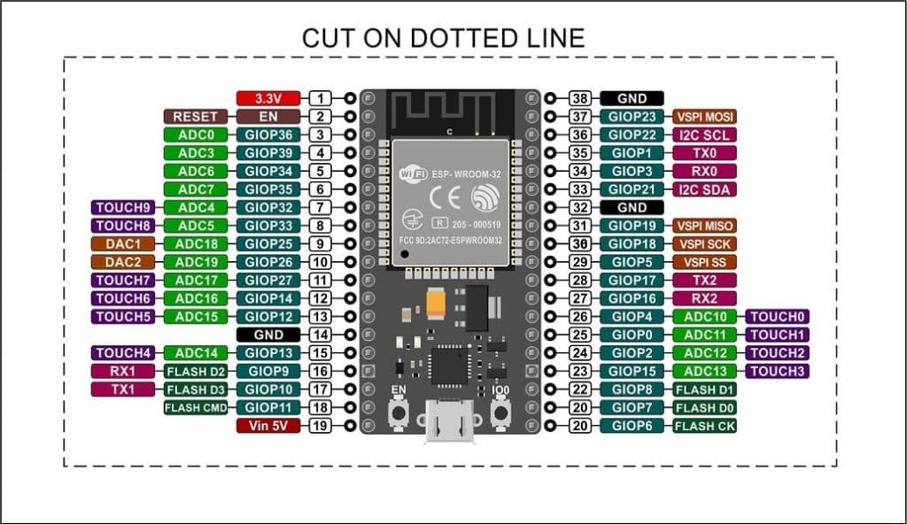

are you powering the LoRa module? from 5V or 3.3V? I used 3.3V
I also used 3.3v for lora, I already using now my bench power supply to power my esp32
what ESP32 module are you using?
nodemcu esp32-s this one to be specific
Thank you so much @horace , it is indeed a power supply issue, and also the code you have sent earlier, I combined it with the code I am currently using and I can now receive.
