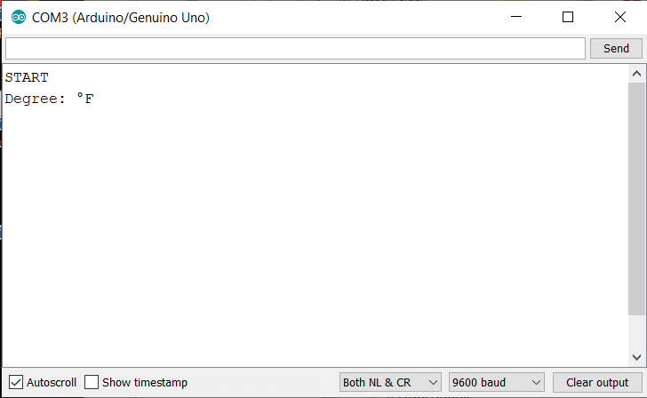

I have code that sends a degree sign as serial output but it show up as ?? under any windows program I use instead of the ° sign.
Serial.print("°F, ");
Gives me ??F,

When I run this program on an Arduino UNO:
  Serial.println("START");
  Serial.println("Degree: °F");
I get the following results when I use...
Serial Monitor of Arduino IDE:

So 2 out of these 3 serial terminal applications can display the degree sign as desired. (By the way: the degree sign is not within the standard ASCII range).
As already mentioned the application needs to support UTF8.

With Termite (my non UTF-8 application) the degree sign will be displayed with code like this:
  Serial.print("Degree: ");
  Serial.write(176);    // the degree sign (for non UTF-8 apps)
  Serial.print("F");
  Serial.println();

I decided to put a ~ instead of the ° sign and change it in the program on my PC that reads the data. This works fine and is the only program I plan to use to get the data anyway.
What are you coding with on the PC side? It’s weird it does not support UTF8 or Unicode
I am using Visual Studio 10.
Maybe it as something with the data coming in from the serial port.
I use this with the degree sign and it works fine.
Tdata = ComData.Replace("~", "°")
