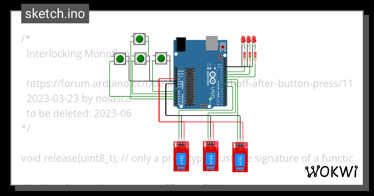

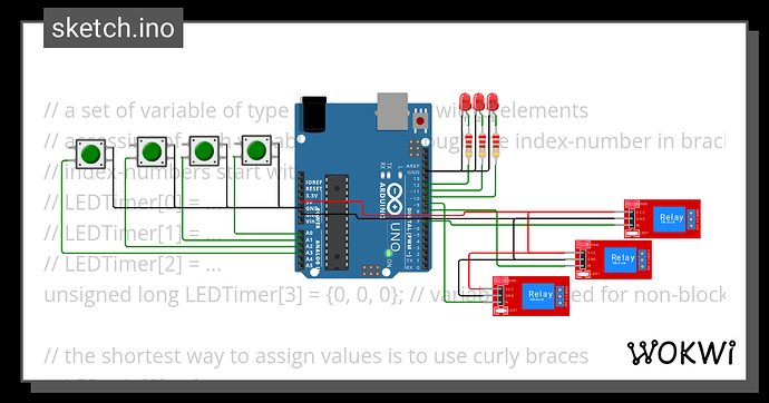

My current setup is that i have 3 relays, 3 led's, 4 buttons.
If button 1 is pressed relay 1 would be the only one active, led 1 would come on (all other would be off)
If button 2 is pressed relay 2 would be the only one active, led 2 would come on (all other would be off)
If button 3 is pressed relay 3 would be the only one active, led 3 would come on (all other would be off)
If button 4 is pressed no relays are active and all led's are off
I'm currently using this to define the pins:
#define LED_PIN1 6
#define LED_PIN2 7
#define LED_PIN3 12
int relay1 = 11; //Amp CH1 relay
int relay2 = 10; //Amp CH2 relay
int relay3 = 9; //Amp CH3 relay
int button1 = 2; //CH1 Button
int button2 = 3; //CH2 Button
int button3 = 4; //CH3 Button
int button4 = 5; //CH4 Button

you have at least 2 options:
a) either just declare a fourth monoflop with a buttonPin but the outputPin at one GPIO which is not available (not connected). for example 255 can be used on most microcontrollers.
b) check the state of the fourth button in loop and call the function "release(255)". This will end all monoflops.
What do you think makes the code cleaner?
I would say option B makes it look cleaner..

Ok, i think i'm very close now to getting this working with the help of @noiasca code
I have the buttons working with the LED's and the relays. The LED's are on a time delay and unfortunately so is the relay's. What part would i need to change to get the relay to stay on.
When button 1 is pressed LED 1 will light up and also relay 1 will switch on. When the time lapses LED 1 goes out and so does relay 1.
  Interlocking Monoflop

void release(uint8_t); // only a prototype - just the signature of a function implemented later in the code
// a class for one button, one LED, one Relay
class Monoflop {
    const uint8_t buttonPin;     // the input GPIO, active LOW
    const uint8_t ledPin;        // the output GPIO, active
    const uint8_t relayPin;      // the output for relay
    uint32_t previousMillis = 0; // time management
    bool state = false;          // active or inactive
  public:
    Monoflop(uint8_t buttonPin, uint8_t ledPin, uint8_t relayPin) : buttonPin{buttonPin}, ledPin{ledPin}, relayPin{relayPin}
    void begin() {                         // to be called in setup()
      pinMode(buttonPin, INPUT_PULLUP);
      pinMode(ledPin, OUTPUT);
      pinMode(relayPin, OUTPUT);
    void off() {                           // handles switching off
      digitalWrite(ledPin, LOW);
      digitalWrite(relayPin, LOW);
      state = false;
    uint8_t getLedPin() {                  // returns the ledPin
      return ledPin;
    void update(uint32_t currentMillis = millis()) {   // to be called in loop()
      uint8_t buttonState = digitalRead(buttonPin);
      if (buttonState == LOW) {
        release(ledPin);
        digitalWrite(ledPin, HIGH);
        digitalWrite(relayPin, HIGH);
        state = true;
      if (state && currentMillis - previousMillis > 1000) {
        // only the LED, not the relay
        state = false;
//create 3 instances (each with one button and one led/LED)
Monoflop monoflop[] {
  {A0, 12, 9},  // buttonPin, ledPin, relayPin
  {A1, 11, 8},
  {A2, 10, 7},
  {A3, 255, 255},
void release(uint8_t currentPin) {   // release all outputs beside the current output
  for (auto &i : monoflop) if (currentPin != i.getLedPin()) i.off();
  for (auto &i : monoflop) i.begin();
  for (auto &i : monoflop) i.update();
some adoptions to stop that blinking in case the button gets pressed for longer time:

wokwi to test
