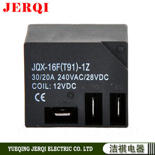

I would like to design a PCB that there is 16 relays on it that each one is 220vAC 25A.
How much should I take the diameter of tracks on the PCB for this Ampere, and any good tips if somebody has for my design, Please.

I'm using JQX-16F(T91) as a relay and ULN2803 as driver.

That uses spade terminals so connection to the PCB for the high current path is not needed.
Just use cables.
