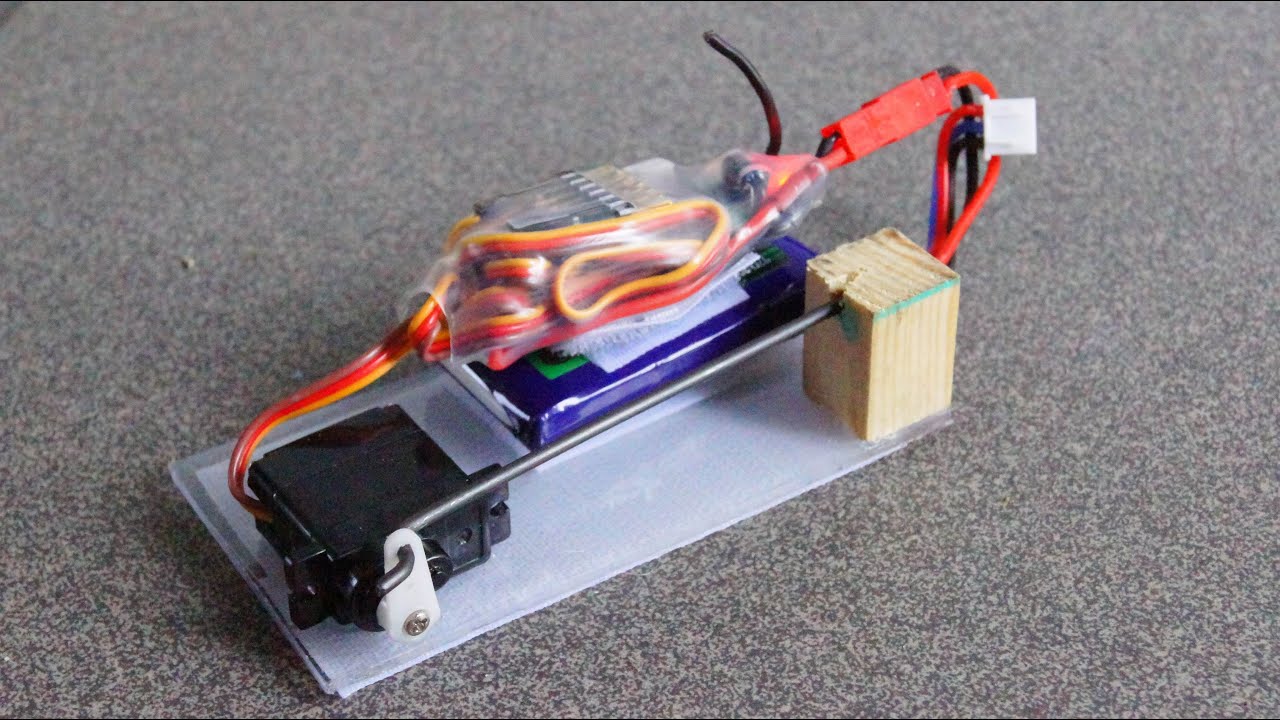

A small servo to push or pull the locking pin would be my choice.
...R
Thanks for the suggestion

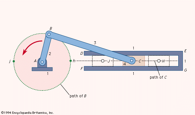

Could you send my a drawing of some sort? How do you convert the rotational movement to a longitudinal one?
The servos come with an arm that attaches to the output shaft. Just put a suitable link (perhaps made from piece of a paper clip) between the servo arm and the locking pin.
...R
I notice the lid is spring-loaded. That may introduce some resistance to the action of a latch.
Note that a servo must be powered to operate - it will have a standby current so to operate from batteries you will need a FET to disable it until needed. Not quite as much current as the solenoid, but quite significant (generally up to an Amp).
Obviously you require power both to engage the latch and to release it if you use a servo, unless you manufacture a spring-loaded latch - like the solenoid - which is temporarily displaced as you close the lid.

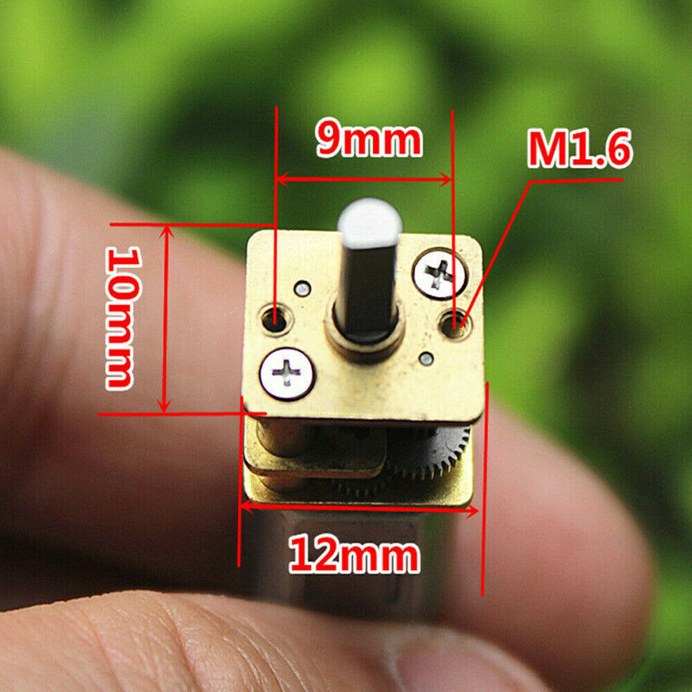

Other possibilities might be a small "gearmotor" which will have a much higher torque than the servo but could have lower current consumption.

Paul__B:
Yes good idea that could work and so could a servo. How reliable would the rotational to linear, mechanical mechanism be? Is the photo below what you were thinking of? Not sure if there's a simpler/ more reliable way? Any photos/diagrams of how to implement it into lid would be amazing.
willpowell:
I. How reliable would the rotational to linear, mechanical mechanism be?
Very
Yes

Servo could actually be powered down when not required.
Checkout around 1:30 into the video below....... crude but workable.

bluejets:
https://www.youtube.com/watch?v=sm1EgAaD-jw
something like this could work nicely, although more secure.
