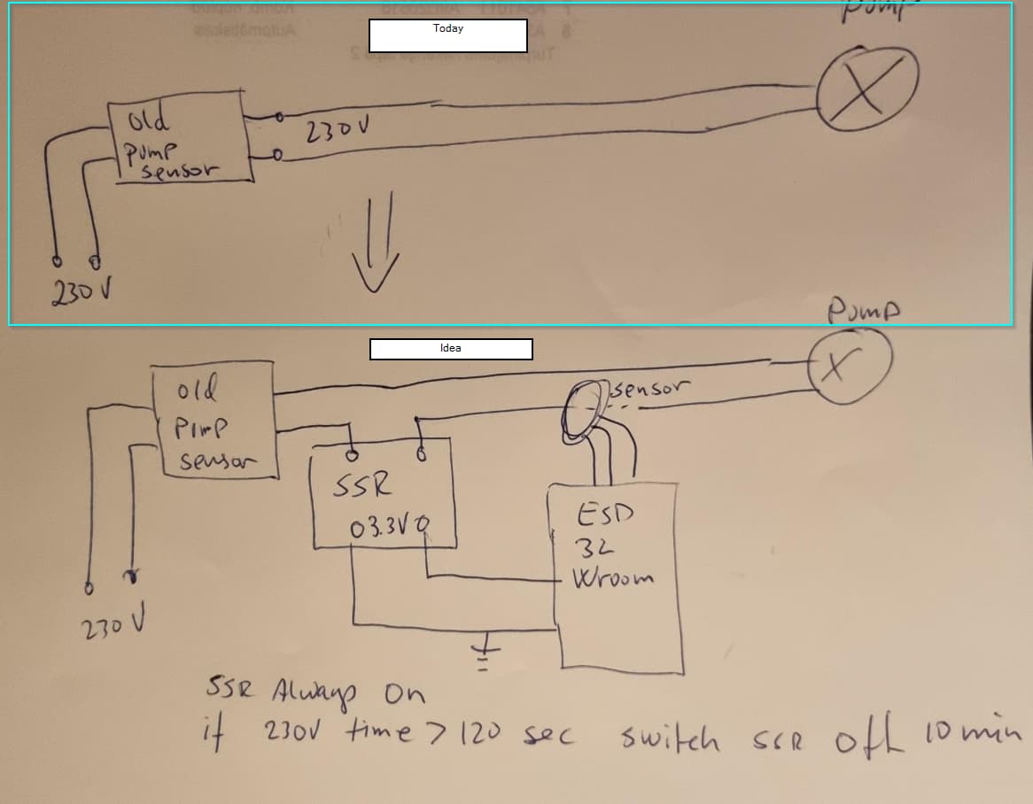

Here is what I have
Idea:
Parts
Sensor connections
Backside sensor
So can this be done?

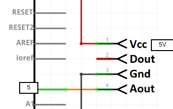

Sensor has VCC: Use 5 or 3.3V?
Dout: Is that I2C? or something else
Aout: Analog out, to a analog GPIO?

It has a cord with a plug that goes into the old pump automation from Filtreau.
On of the outlets is controlling the pump. But it sometimes dont switch it off
I see. Can you make or find something to go between the controller outlet and the pump plug so you can tell if the pump is off or not? A box or and extension cord or a transformer or?
Yes, exactly.
if power on > 2 min then power off for 10 min
Then maybe your Filtreau unit is bad. I would replace it before it completely fails and causes pump damage.

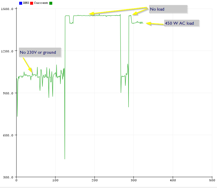

Code is compiling and I can make it work but maybe some calibration I don't understand
Measurement
No load, no 230V connected = RMS between 70 and1100
No load, connected to 230V + earth= RMS ca 1451
Load 450 W = RMS 1399
NB measures under may differ from numbers above because this was the first readings but I hope it gives some input to you.
1: Expected RMS to increase, maybe wire in WCS1500 shall change direction
2: Diff RMS load/no load = 52, this number don't make sense for me.
Can I ask you to give me a tip so I manage to read 450W RMS?
