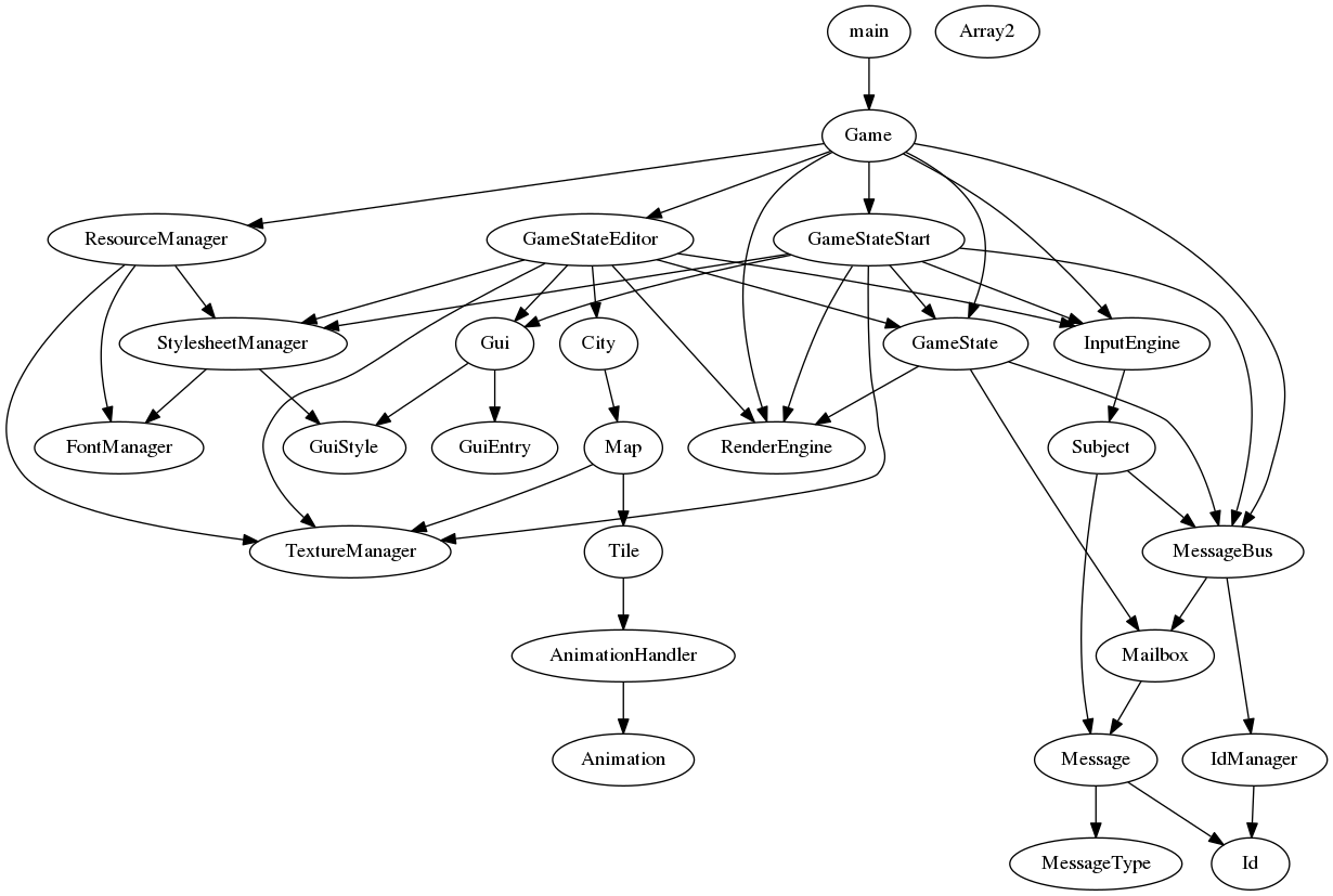

I came across a very useful tool for detecting circular dependencies while converting my project from many .ino files to use .h and .cpp files instead. I unfortunately created some circular #includes when I initially partitioned the code from my .ino files and this tool was very helpful in visualizing what I had done wrong and then improving my design.
It's a python script that can be run against your project folder to create an image like this example. I got it to run on OSX but since it's python code it's intended to run equally well on Linux and Windows.

And there are some circular dependencies that can creep in even if you have include guards. So having a dependency graph is good to have even if it's just to have a clear picture of the structure of your sketch.
