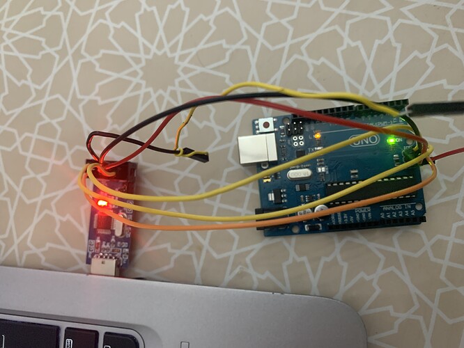

DFU Arduino Uno R3
Same problem
what option have you here

set "usbasp speedLow"
and it can be like i said "UsbAsp stick can be faulty", some are sells with unusable FW and must be updated.
to check if it works, try reflash atmega328p or just read data from it.

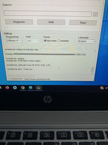

As you can see it’s working
I noticed something, the small microcontroller is labeled L16U2, not Atmega16u2 , Could it be because of that?
you have just overwritten the HEX file that is prepared for the atmega16u2.
we hope this clone is a good copy
hope yes , i tried to read what is inside this Atmega Copy and i'm not able to read it ( error )
try read fuses, this will not every time destroy the Hex file. because READ write from flash to chosen file
