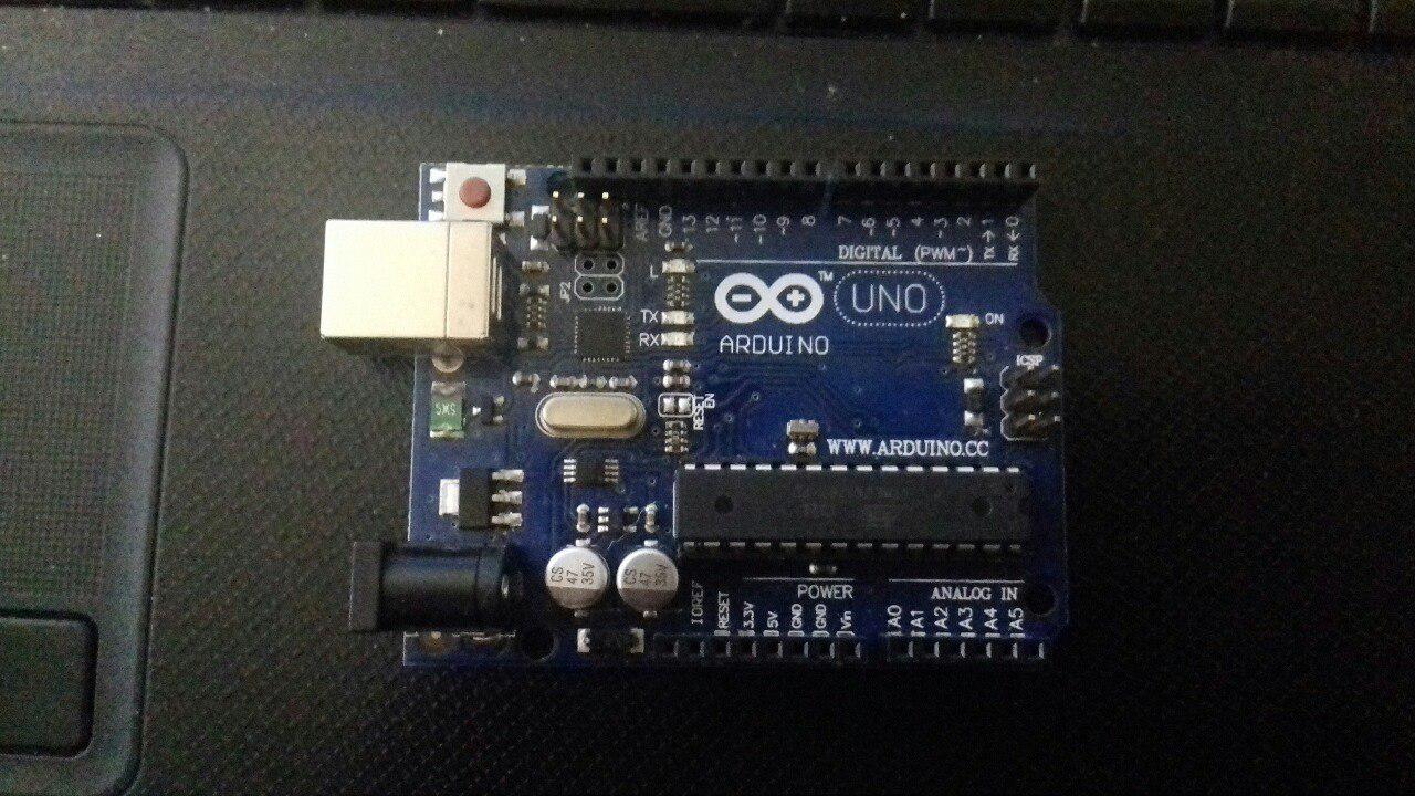

Hello,
Well mine is a genuine Arduino UNO R3 and there is a 16u2 on the board but no matter what I do, it won't go into DFU mode.
"shorting" the pins on the icsp header just resets the uno but it won't enter DFU mode.
I've seen a whole bunch of threads with people having this problem, but either there is no reply which solved it or the topic starter replies with "I got it working", but doesn't tell how
See the photo's in the attachments
.... is that a counterfeit?
It doesnt have the right ptc fuse!
DrAzzy:
That is absolutely a counterfeit. The fonts are all wrong, and the blue is the wrong tone too.
hmm so this is not a real arduino.
That sucks.
think I might have to get my DFRDuino UNO back, since I could get that into DFU mode.
Or can something be done about this one?
