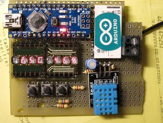

I have connected a DHT11 sensor to a nano atmega 328.
Note that I also use an interrupt driven routine to maintain a real-time-clock. Measuring the DHT11 pulses that are just a few microseconds, I had a lot of trouble with time-outs and correct data, as the RTC clock routine interfered with the microsecond time measurement.
I fixed this by syncing the DHT11 code to a point in time where the interrupt routine really does not do anything (things happen at second roll-over in the RTC routine).
Now that I have fixed this, I still get checksum errors, which appear temperature dependent. I added debug code, and for instance found that when temp=10C, the sensor often sends 00000001 for temp byte, completely leaving bit 3 at zero (temp byte should be 00001001). The checksum is actually correct for what the temperature byte should have been.
Has anybody seen this? Seems the sensor is (somewhat) broken - a data dependent malfunction?
I only have one DHT11, so I cannot easily try another...

How did you connect the DHT to the Nano? What resistor did you use, how connected?
  • don't remember which library version I patched - I worked on that a year ago and made some forum posts about timing and microsecond calls.
  • connection: GND to GND, VCC to 5V output of nano, with Capacitor, data pin to A4 (all digital only pins are used to connect a display). See picture.

Seems that the 10k ("103" on the SMD) resistor between data and Vcc is already on your DHT breakout. So it seems ok for me.
In case you fear the Nano is a problem. Can you tap the DHT with an Uno or other "proofed" MC and test if this is working? So you can exclude that the DHT itself is working?

and guess what. I get no more CRC errors. For some reason, when humidity is a certain value, the temperature is either 8 or 4 degrees too low on certain readouts. Seems like bits are stuck internally in the DHT11. I checked power supply which is fine.
I have no other arduino nor sensor to play with at the moment.
In hindsight, there were two issues at the same time: timing issues with the code and a partially working sensor which made it interesting to debug.
I will order a new sensor...
