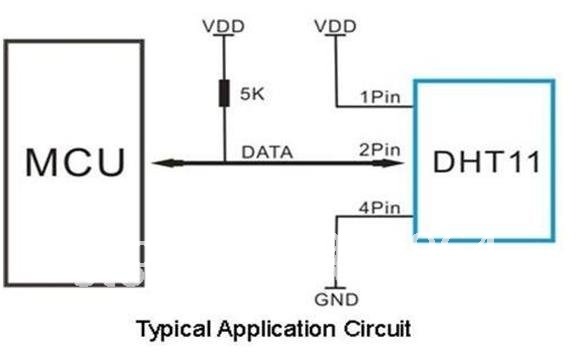

the sensor is like this one:
alfcasmo:
Circuit diagram?
Some DHT libraries activate and use the internal pull-up resistor of the Atmega controller to pull the data line HIGH.
And some other DHT libraries rely on an external pull-up resistor.
To make sure that your schematic does not lack the pull-up resistor, use an external pull-up resistor, connected to "data". Resistor value something like 3.3K to 10K.
Does the library manual tell you that you will need no external pull-up with that library?
Or do you have the external pull-up resistor connected to the data pin?
It's AOSONG DHT11 AOSONG DHT11
There's full specs DHT11 AOSONG full specs

Also tested to pull up with 10k resistor at data pin. :frowning:

Perhaps try this code (no library required):

Connect:
VCC to VCC
GND to GND
DHT11 data pin to pin-2 of the Arduino UNO.
No pull-up resistor needed, code will use internal pull-up.
Open the serial monitor at 9600 baud. What does the serial monitor show?

Jurs !! you are again my new god... wow :smiley: impressive!
Humidity: 71   Temp: 22     raw data:  71	0	22	0	93

Can i know how? why doesn't works with lib dht and yes with your code?
Thanks man.. I will finally have to pay you ^^
alfcasmo:
I don't know for sure.
It must be either an issue with the timing and/or the protocol of the libraries. Seems to be dependent on the Arduino IDE software version: Newer Arduino versions and older DHT libraries seem not to work in several cases.
Perhaps I should make a DHT library from my code and offer as an alternative for downloading.
