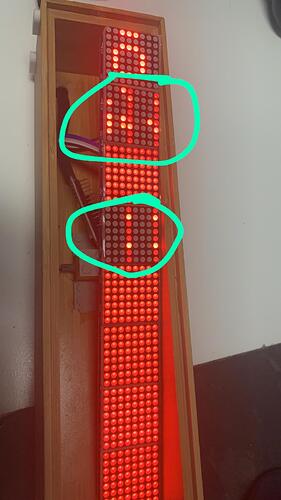

Okay guys, do you have the nerves for another round of "lets find the problem" :smiley: ?
In the same time i ordered a 16x64 Matrix from the following page: https://de.aliexpress.com/item/4000350837123.html?spm=a2g0o.cart.0.0.6a133c00YIA3yR&mp=1
But everything i get from this matrix is the following picture, all lit up (except the first two).
What i already tested:
-The Modules from the 16x64 Matrix are fine, they work on an other Matrix completeey fine!
-Modules from a working Matrix arent working on the 16x64.
The code i used is the MD_MAX72XX_HW_Wrapper with the following config of wiring:
// Hardware definition
#define CLK_PIN   14  (SD3 on ESP8266)
#define DATA_PIN  13 (D7 on ESP8266)
#define CS_PIN    10 (D5 on ESP8266)
Does anybody has a hint or did somebody make a 16x64 Matrix work?
Have a great weekend! And thank you in advance!

I was inclined to wonder what would happen if you took the incorrect 1088B modules from the rogue matrix and tried them in this one, but looking at your last image
This definitely is an FC-16 design (variant - two rows) so should have the code configured as such. If it does not work with the correct code, then you have a wiring fault whether in your connections or in the module itself.
Have you tried swapping the modules between the lit and unlit sections of this array; what happens? Note that it is a good idea to have a 10k pull-up on either "DIN" or "CS" when using the MAX7219.
Nothing happens, when i switch matrices from the lid-section and the non-lid-section, still only the right section lids up.
I also tried adding a 10k, but nothing changes.

Well that indicates that the LED modules are themselves functioning. Did you try putting them in the other ("your "second") module with the 1088B matrices?
There is some concern that MAX7219s powered by 5 V may not respond properly to 3.3 V logic from an ESP8266 (page 3 of the datasheet) though I have had no problems and your diagram suggests that you are actually powering them from 3.3 V which introduces two problems - firstly they are not specified to operate at 3.3 V (again, page 2 of the datasheet) though others report them working fine from a 3.7 V LiPo battery as you would expect with red LED arrays (which do not take as much voltage as green or blue) since they are CMOS devices . The second concern is that attempting to power a 16 module array from the 3.3 V line of a NodeMCU will overload the regulator.
You should be testing this with a 5 V Arduino such as a Nano, powered from a 5 V power supply to the "5V" pin. And my suggestion, FWIW, was a 10k pull-up, not a series resistor.
It really does sound like either a wiring fault or a dead MAX chip. Check the soldering of the first chip.

Little Update: Ordered a new big Matrix from the following page: https://de.aliexpress.com/item/4000220527655.html?spm=a2g0s.9042311.0.0.4a044c4dAkTcZI
This new Matrix is now working perfectly! So probably a dead chip on the oldMatrix :slight_smile:
Thank you for your help!
From China, that was rather quick!
Yep, dead chip or bad soldering.
