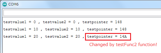

reference to pointer. when pointer is passed to a function normally it gets copied, but in this case it is passed by reference and is changed inside the function so original pointer is now pointing to a new chunk of data.
If you pass a value to the function, it will be copied and used as another value.
So, by passing it as a pointer to the function, it tries to change the original value instead of copying it.
It's the same thing.
If you pass a pointer to the function, it will be used as another value.
So you can change the original value instead of copying it by passing it to the function as a reference to a pointer.
Try running this code. (Available in Uno and Nano)
In testFunc1, the value of the original pointer has not changed.
However, in testFunc2, the value of the original pointer has changed.
int testvalue1 = 0;
int testvalue2 = 0;
int* testpointer = &testvalue1;
  printValue();
  testFunc1(testpointer);
  printValue();
  testFunc2(testpointer);
  printValue();
void testFunc1 (int* value) {
  *value += 10;
  value = &testvalue2;
  * value += 10;
void testFunc2 (int*& value) {
  *value += 10;
  * value += 10;
void printValue() {
  Serial.print("testvalue1 = ");
  Serial.print(testvalue1);
  Serial.print(" , testvalue2 = ");
  Serial.print(testvalue2);
  Serial.print(" , testpointer = ");
  Serial.println((unsigned int)testpointer, HEX);
In testFunc1, value is the value of the copied pointer.
So, if you change the value, doesn't change the original value.
In testFunc2, value is a reference to a pointer.
So, if you change the value, the original value will change.

It doesn't make sense if you don't need to manipulate of the pointer original value in a function.
not sure what doesn't make sense
References to pointers exist to manipulate the value of the calling pointer variable.
The function in code you provided didn't that.
not sure how this is relevant to *& combo
are you suggesting you would only ever pass a pointer if the modified value needs to be returned?
doesn't in make sense to make sure the use of "*symbol" and "&symbol" is clear?
Not passing a pointer.
Passing a reference to pointer.
If use * symbols or & symbols, has not same result for *& symbols.
Take a closer look at my sample code and the execution results.
