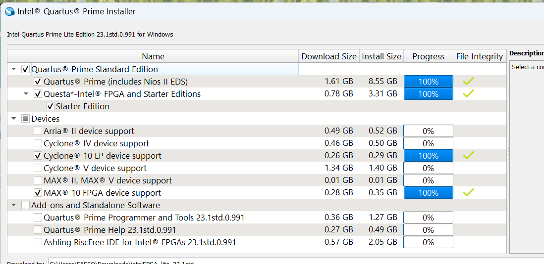

Just got a Vidor for christmas, and I have difficulties with Quartus IDE.
Apparently, layout of the download pages changed since Vidor tutorial.
I downloaded Quartus Lite + Cy 10 support, as per attached image.
But I cannot find the definition file .QDZ (or is it named config ??) for the Cy 10.
Some help would be welcome.
Thanks
Gerard
The path where the files downloaded to is right there, below the list of software to install, you've cut the screenshot right in the middle of that "Download to: " field.
Also, why do you need the .qdz if the installer pics up all the downloaded files automatically when you install Quartus? If you add the new device support into already existing installation, then it was done with a separate "Device installer" application, at least in previous versions of Quartus.
Note that the default projects were made with older version of Quartus. Arduino introduced a variation of the existing flash controller, patched up for the flash chip installed on board, and the patch was made against very specific version (18.1) of Quartus, it will fail to apply in newer versions.
