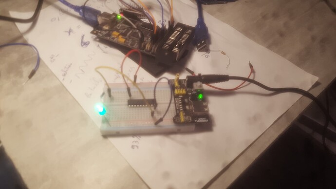

Hello Friends,
For testing my attiny2313a, I used the blink code and a AVR Dragon programmer and attiny core as hardware.
I don't have any errors but the led don't blink.
I missed something but I don't know what that?
My setting are :
The pin used is D7 (pin 9) and the file .hex code in the atmel studio.
Someone can help me please, Thanks

pin 9 is PORTD5 if you are using the PDIP version
This should turn ON the LED at least
DDRD |= 1<<5;
PORTD |= 1<<5;

Assuming the IDE gave you confirmation of a successful upload, how and what else do you have connected ?

After I upload this file in the attiny2313a by AVR Dragon.
I connected my attiny like that:
Pin 20 --> 5V
Pin 10 --> GND.
Pin 9 --> Led.
The wiring is not complicated.
Migh be the problem come from the file of management card in the IDE or the fuse in the ATMELSTUDIO.
Migh be another cause, I don't know
Pin 1 (Reset) needs to be pulled HIGH, i normally do via a 10K resistor, or it won't start up.
I do hope you are using a current limiting resistor icm the LED.

I connected the reset pin to 10k resistor and the other pin of resistor to 5V,but nothing happen.
for information : the ISP clock is set : 125Khz in the ATMEL STUDIO et 8 Mhz in the IDE.

int led=7;
Then you have connected the LED to the wrong pin.
ATtiny2313
You have it connected to pin 7 which is GPIO 5
But you have defined it as GPIO 7 which is pin 9

By now i don't really believe you anymore. If the uploader confirms the upload and the connections are correct, it should work.
Even though the board you are using to power the chip is known to be of poor quality , (the regulators have apparently have no heatsink to speak of) the 2313's power requirements are so low it should not pose an issue, also because the 2313 will be happy with 2v at 8MHz.
The only thing i do differently is that is use Arduino IDE and an UNO as ISP uploader.
So then there is just a general advice. Disconnect everything, and re-connect everything, check that the ATtiny is actually getting the 5v. Confirm that the led is working by connecting it between 5v+ ( instead of GPIO 7) & GND
Confirm that the wires are actually making contact with the Pins of the IC (all looks good, but looking is no confirmation)
If that fails, how about just using the IDE to upload to the ATtiny ?

before asking help i already do that many times and I chang many thing without succes.
My led work correctly when i connect it directly to 5V.
yes I check that, all wires are making contact
If you have another method, why not?
I think, This night, I will change the CPU (Attiny2313a), may be it not function.

Because if it's not the connections, it's not the sketch, it's not the upload method, it's not even the power supply, then that leaves the Chip itself. Let's hope it's that, otherwise i'm stumped.
good news friend,
The problem was the Chip itself, that fucntion with new one, but not like what I expected, because , I have two follwing unanswered questions :
1 ) the delay of blinking in th code is 1 second, but in my test the blinking is about 8 second! why?
2) the code uploaded in the new CPU was without bootloader? that's mean this CPU not need bootloader like attiny85, Why?
N.B : the resistor of reset have not any impact on operation
I'd say both questions share an answer, though it's guess work for me. The bootloader on an ATtiny13 is not more than setting the fuses for the clockspeed, and i recon that is why.
