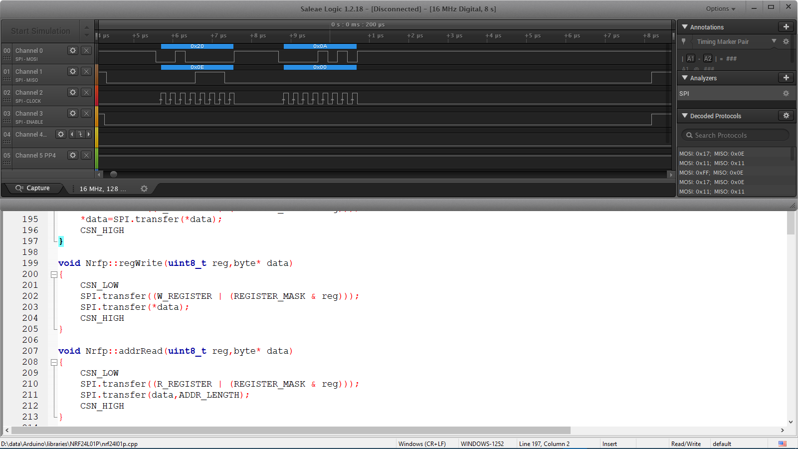

digitalWrite in question ?
Hi
That is SPI communication.
You can see on the linked screen a long delay (about 7uS) between end of transmission and CS high.
Code is below (regWrite function) and CSN_HIGH macro is
#define CSN_HIGH digitalWrite(csnPin,HIGH);
There is no delay between two access to SPI.transfer, and I can't imagine how digitalWrite could have a latency of 7 uS.
UNO board at 16MHz ; SPI speed 4MHz
A look to spi.h doesnt explain either

Any idea ?
max777:
The digitalWrite() function is slow because it has to figure out which pin on which I/O port needs to be changed.
There is a digitalWriteFast library which is very much quicker - but it requires the I/O pin to be known at compile time.

You could measure the time that is used by digitalWrite().
You can use my millis_measure_time.ino sketch and replace analogWrite() with digitalWrite() in three places.
I did not test it myself, but I know from the past that it is 5 µs.
The ATmega328p only needs 0.125 µs to change a pin. The 5 µs is Arduino overhead.
The SPI code uses the SPI hardware of the ATmega328p, and uses even "inline" code to control the hardware. That is very little overhead.
So everything seems just as it should be. If you want to know exactly what is going on, then you should read the assembly code that is generated by the compiler.
If you change something in other parts of the sketch, then the compiler could decide to optimize this code in a different way, and that could change the timings.

Can you have a look on the logic analyser window (attached to my first post) ?
About 1 uS from end of transmission to start of next transmission. I guess there is not a different delay from end of SPI.transfer to digitalWrite() beginning.
About 7 uS from end of transmission to CS high ; so digitalWrite means "at least" 6uS + the time to "return" after setting of CS. 8uS seems not so suspicious...

So much function call means so much time... I will write my own digitalWrite() :slight_smile:
With digitalWriteFast I get a little less 7uS...

The AVR microcontrollers have a special assembly instruction to change an output pin. That is the "direct port manipulation" and takes 125ns. You can use that in your code, or use the digitalWriteFast, which is trying to do that if everything is known during compilation.
The Arduino macro bitSet() and bitClear() can be used with a register and are translated into the 125ns direct port manipulation.
The SPI.transfer() function has to return, and the Arduino digitalWrite() changes the pin at the end of the function. Perhaps an extra microsecond for the variable 'csnPin' and then there are still 2 µs that I don't know :confused: Perhaps an extra microsecond because the Arduino optimizes for size instead of speed. The remaining microsecond is within the margin of error :wink:

To close the subject...
I'll use ATMEGA328 @ 8MHz for very low power application so I can't go faster than 4MHz for SPI.
As I'll use 8MHz, 8uS delay @16MHz will be a 16uS delay...
Multiple Spi transfer AND bit manipulation around, take more time than slave device operations, that why I had to examine where time is wasted.
I solve that issue with the excellent advice from Koeppel (bitset and bitclear) I'm a newbie with Atmel so I didnt know these macros. (@Koeppel ... my poor english... I've seen the link and the source code... that is very well explaining why digitalWrite() is so slow. thx).
But... Special thx to Robin2 ! I will remember the lesson (mistyping... 7 was 1).
With 100 loops I found 4,36uS for digitalWrite() ; with 1000 -> 3,38uS and with 10000 -> 3,28.
Same for digitalWriteFast 1,24uS / 0,24 / 0,14
(toogle a bit)
For me it's a mistery...
Anyway, the "real" time to execute 1 single digitalWrite after SPI.transfer to put CS high is about 8uS (logic analyser mesure).
