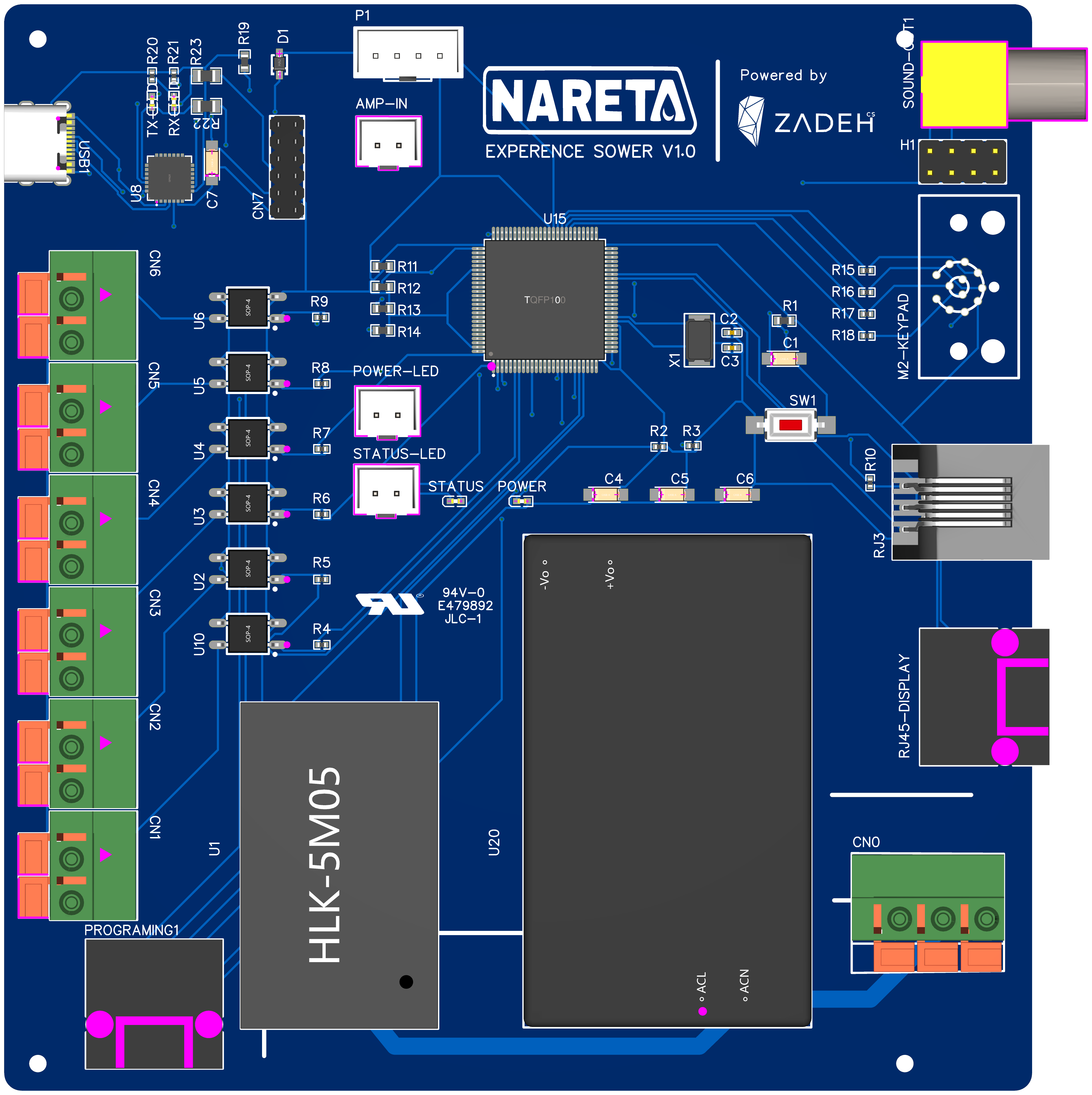

hi have designed a custom
Arduino board wit usb programing port using CP2102N and printed the pcb board now atmgea is working fine with the oter programing board on board programmer is not working
this is the schematic diagram
https://www.instructables.com/USB-TO-UART-CONVERTER-the-CP2102/ reference file which i followed .as i am new to atmega and usb to uart converter is guide me this i cant find the issue in pc com port is geting visbile but cant commplete the downloading's
reference images

Does the ATMega2560-16AU have a bootloader installed?
do I see that you have the USB converter connected to RX1/TX1 ?
The normal ATmega2560 bootloader only listens on RX0/TX0...
If you're using MegaCore, there's an option to use the bootloader on UART1, but you have to select that before you do the "burn bootloader."
do you have any reference link for that
no i am using tx0 rx0 only
i have jumper connector in-between just to sperate the incase if the converter is not working
