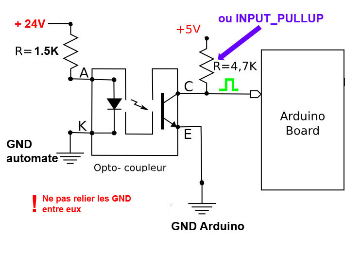

As a safer alternative you could use optocouplers as long as you can get 5mA or so from that sensor. You would have to read the datasheet to find out the forward voltage of the opto-coupler's LED to work out the resistor values.
Example: your optocoupler LED requires 4mA with a forward voltage drop of 2.1v. Therefore you need to drop 21.9v at 4mA so that's 5.5K - nearest preferred value would be 5.6K.

I prefer the solution of an opto coupler so a friend of mine draw me this scheme but since I'm a newbie I can't say how he choose the resistors values. Does he just calculate it with for exemple the input/output voltage and the max current we can put in the optocoupler and the max current the arduino allows? Or should I measure the current that comes with the 24V? Thanks in advance
