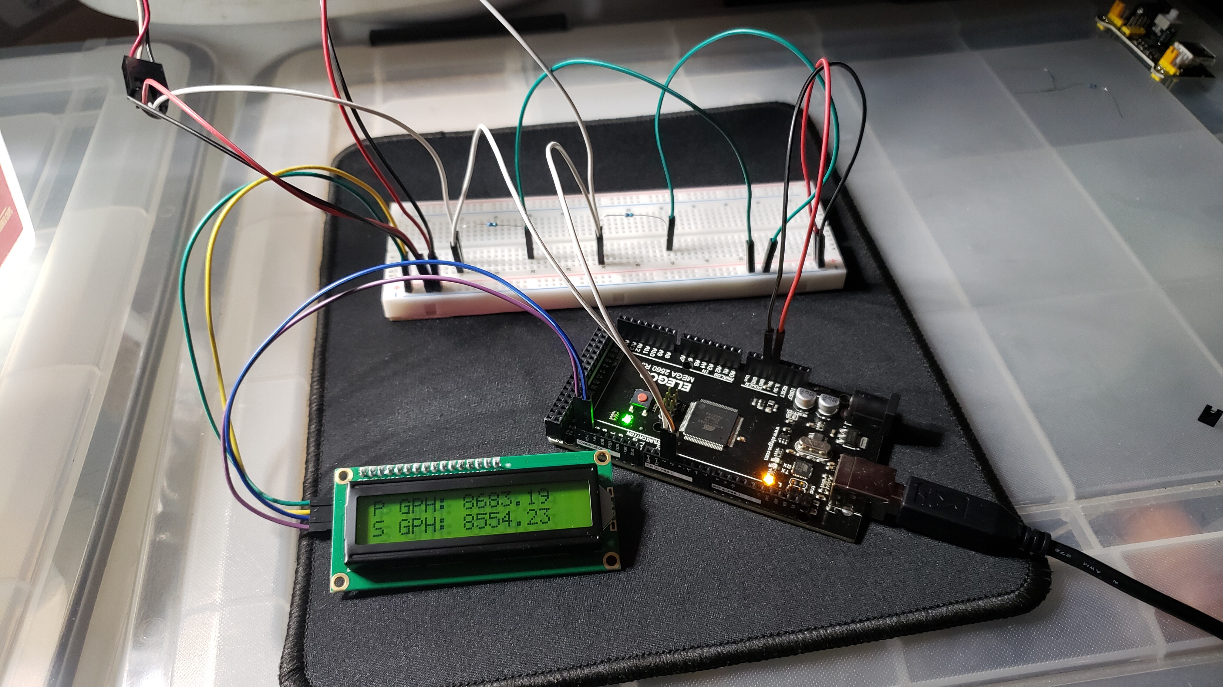

this is what i have rn, i couldn't find a 1k resistor so i put a 1.5k and im getting no output with the pull down wired

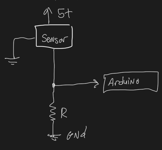

That's because you are bringing the signal straight to ground with that green wire. Wire it like the image here.
Screenshot 2023-11-12 at 7.13.44 PM
(I can't draw for sh!t lol.)
like this? because the numbers are still way off
also remembered i can turn off the back light

If you still have the 10k resistor, try putting that on and see if the values change.
ok so the data sheet says 0.46mL/P already have the number of pulses in one second which is countPulsePin2 and 3.
So the calculation should now be pulseCountPin2 * microlitersPerPulse * 0.000264172052 * 3600
10k and they didnt change and the numbers are on the back

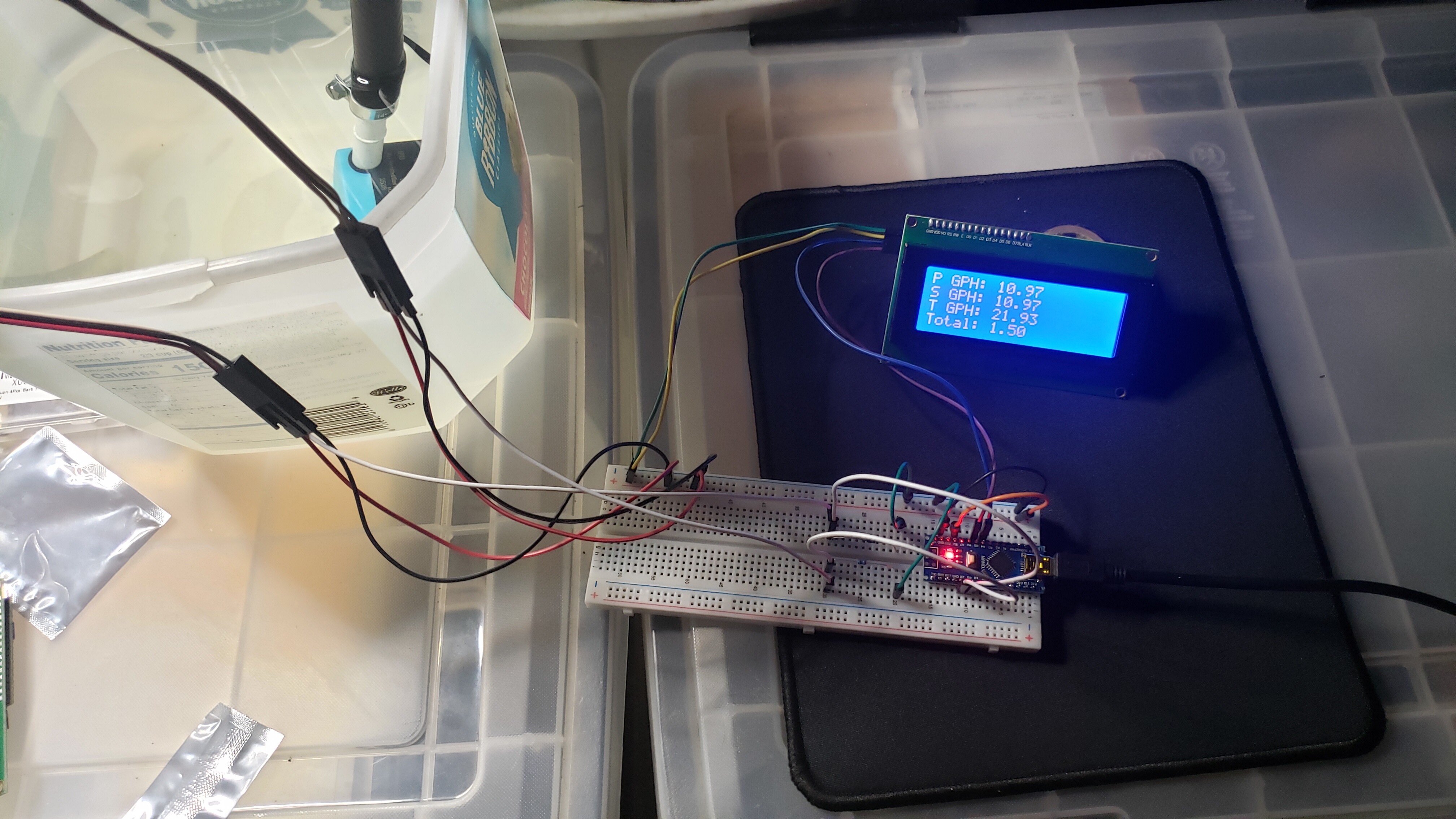

After some fine-tuning and testing, I got it all working. I know P and S GPH are off, but they fluctuate a bit, and I'm fine with that.
I ordered an Arduino Nano and a proto board. I'm going to make an enclosure and test it on an old truck I have. I'll make sure the sensor is gas-rated 1000% before I put it in the boat.
If anyone sees anything wrong, let me know; I'm still kind of winging it.
