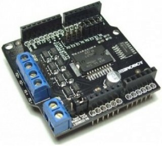

Do not know how to run forward the dc motors.
I am buying the motors shield this: http://www.dfrobot.com/wiki/index.php?title=Arduino_Motor_Shield_(L298N)_(SKU:DRI0009)
and plugged in to arduino uno, to control dc motors like in this robot kit: 2WD MiniQ Robot Chassis+ Kit | Famosa Studio
I am using PWM mode.
And the programming code following from dfrobot:
//Arduino PWM Speed Control?
int E1 = 5;
int M1 = 4;
int E2 = 6;
int M2 = 7;
    pinMode(M1, OUTPUT);
    pinMode(M2, OUTPUT);
  int value;
  for(value = 0 ; value <= 255; value+=5)
    digitalWrite(M1,HIGH);
    digitalWrite(M2, HIGH);
    analogWrite(E1, value);   //PWM Speed Control
    analogWrite(E2, value);   //PWM Speed Control
    delay(30);
the motor works rotating backward with this code, but how to run forward?
Please help! I heard this shield can have bidirectional rotation :grin:
Did you read the dfrobot page you attempted to link to? There is a table about half way down that shows what the pins are used for in each mode. Some pins are described as direction pins. Setting a direction pin (M1/M2 in PWM mode) HIGH sets that motor to backward.
dxw00d:
Oh yeah I read that mode.
But how to sets the motor to forward?
Really? It's a direction pin. It can be set HIGH or LOW. HIGH sets the motor direction to backwards. Try the alternative option.
When I set to LOW, the motor is disabled, not moving forward.

Okay - do you have the motor shield set for PLL or PWM? The function of the pins changes depending on how you have the board configured.
It would appear that the jumper by the double screw terminal block needs to be set properly.
In PWM mode pin 4 is motor 2 direction and Pin 5 is motor 2 PWM speed control, Pin 7 is Motor 1 Direction and pin 6 is Motor 2 PWM speed control.

The motor shield set to PWM. well I have made sure the jumper at the PWM mode.
I would like to correct your statement to:
In PWM mode pin 4 is motor 2 direction and Pin 5 is motor 2 PWM speed control, Pin 7 is Motor 1 Direction and pin 6 is Motor 1 PWM speed control.
Well, I have define the output pins properly like this:
