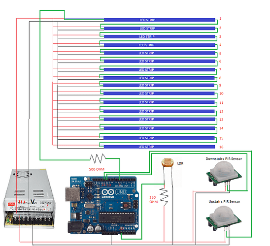

I see on nearly all example projects that it is made clear that the ground of every different components must be connected together, example, a power supply, Arduino, LED strip, PIR sensors, all ground will be connected.
But I was wondering, can this not be a route for electrons to pass and trickle on to another device? Say the power supply is different voltage, will that trickle not cause problems to the other devices?

So in the diagram I posted, assuming the Arduino is getting power via a USB cable (not shown), is the data line an "electrical connection" between the PIR circuit and Arduino circuit? Is this the reason why these two devices will be connected to a common ground?
