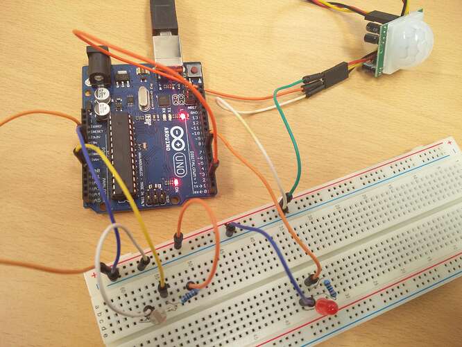

Hello,
I am currently working on a school project: a device that sits adjacent to a door handle and lights up during nighttime when a person is detected moving in front of it. The device is to help seniors with bad eyesight or that are sensitive to light.
The device includes a photo resistor, that when the room goes below a certain level of darkness, turns on the motion sensor. This motion sensor then subsequently turns on LEDs that light up the door handle, when motion is detected in front of the device.
I have found a very similar project on the forums, but I have tried wiring everything up and uploading the code, yet still it does not work: Motion & Light Activated Night-light (lights up if it's dark & there is motion) - Project Guidance - Arduino Forum
This is the first time I am working with Arduino's, and I realize that this project may be rather complex, but it is important to me. I am working with an Arduino Uno, and I need help checking if my setup and my code is correct. Both are attached below. I have also included a flowchart, so that you get the idea of the function of the device.

Please help me.
The flowchart doesn't correspond with either what you say you want to happen, or with the program. It deoperates with an ultrasonic ranging module, not with a PIR detector.
Also, the PIR detector shown in your photo isn't the Parallax one, so a lot of the code is unnecessary. The type that you show doesn't have the fault listed in the program's comments:-

I've used the type of detector that you have a couple of times, and never had the problem described above.
After triggering, the PIR output will go high for the period set by it's timer, then go low unless another trigger has occurred during that period. It's retriggerable, so if movement is detected within the time that the output is high, the time period is restarted.
So you can actually remove most of the code.
That's great! But does this mean that I cannot use the PIR sensor for this particular project? By that I mean, is it even possible for me to use the PIR sensor in combination with the photo resistor and the LEDs?
Also, is the code correct but simply needs for me to delete the parts particular to the Parallax sensor? If not, where can I find a piece of code that describes the actions described in my project i.e. photo resistor activates PIR sensor actives LEDs, and then loops?
16adamm:
No, not at all. The PIR is fine. And that type works very well. I have two identical PIR detectors in my woodwork workshop, used as burglar alarm sensors
Yes, it's a good system.
You need to write the code. If you search hard enough, you might find something similar that you can modify, but surely it's better that you learn to write your own code that does exactly what you want?
The calibration time will probably need to be increased from it's current value of 20 seconds, too. I found with my PIR detectors that they took 30 to 40 seconds to settle down on power up, during which time they false-triggered a couple of times. Do that in the 'setup()' function.
To write your program, draw yourself a flow-chart or pseudo-code, covering exactly how you want the program to function, then write code that follows the flow-chart / pseudo-code.
Basically, what I'd do is create a boolean variable called "isDark" or similar. Then at the start of the 'loop()' function, check the LDR value and if the light level is below your threshold, set "isDark" to true, otherwise set it to false.
Then, only check the PIR detector and light the LED(s) if "isDark" is true.
Fairly straightforward, and good programming practice. Have a shot at writing it, and if you run into problems, post your code here and we can help you get it working properly.
Good luck, and have fun......

16adamm:
1.4. int threshold = 100 // the lumen threshold for the LDR
It's not actually a lumens reading, of course. Just a voltage level.
1.6. int calibrationTime = 50 // calibrating the PIR sensor
40 seconds should be adequate
1.7. long unsigned pause = 5000 // time until PIR sensor assumes movement has stopped
You don't really need this delay period - the PIR detector has a built-in timer. Unless you want to set the PIR detector time to minimum, then write extra code for the timing. If you do, avoid using 'delay()', and base your timing on 'millis()'. 'delay()' is bad practice, and a bad habit to get into.
3.7. Else (digitalRead(pirPin, LOW))
I think you meant 'digitalWrite()' here'. :slight_smile:
"Pseudocode" was probably a poor choice of words on my part.
I meant more like English, less like code. Something that you can easily read and understand as a human, that describes what you want the program to do. Basically a set of instructions in English.
And when I mentioned flow charts and pseudo-code, that was a general guide to writing programs. While it's a good idea, it's barely necessary in this one.
Like:-
Setup Function:-
  • Set up I/O pins.
  • Calibrate PIR detector. (Wait 30 to 40 seconds).
Loop Function:-
  • Test light level.
  • If dark, check PIR detector.
  • If PIR output is high, turn on LED(s) otherwise turn off LED(s).
  • Do it all again.
On reflection since this is so simple, I don't think you'll even need to set an "isDark" flag. Just use an 'if' statement, comparing the analogue reading with your threshold, and the PIR code within the brackets.
One thing that makes this program extra-simple is the fact that the PIR detector has it's own built-in timer. You can set that timer to the period that you'd like the LEDs to remain on after the last movement was detected, and so you don't need to do any timing in the program.
All the program needs to do is check the LDR, decide whether or not to read the PIR, and light the LED(s).
Many PIR detectors have the LDR built in. If you had one of those, you wouldn't need a program or Arduino at all. And, in fact, you could actually do it all easily in hardware even now, with very few components, but I figured you probably wanted to use an Arduino for practice.
3.1. If isDark == true (digitalRead(ldrPin < or = 100))
3.2. Turn on the PIR sensor (listen to pirPin input)
In the case of this, "Turn on the PIR sensor" was a bad choice of words, since you don't want to power up the PIR each time. You definitely only want to decide whether or not to check it and turn on the LEDs. If you power and unpower the PIR as the program runs, you need to wait for it to calibrate each time.
I don't know the number or type of LEDs you'll be using, but if they'll be drawing more than about 30mA, you'll need to add a driver transistor or MOSFET to switch them on/off, too. An Arduino I/O pin can only provide an absolute maximum of 40mA, so you need to keep the current below about 30mA. And, of course, each LED needs it's own individual current-limiting resistor.

Sorry, my bad. It's the way you wrote it.
What I mean is, I was under the assumption that INPUTs (the LDR and PIR) are to be READ and the OUTPUTs (the LEDs) are to be told (WRITE) what to do. Is this not correct?
you're correct - I just covered this above.
You still didn't get the idea. All you're doing is writing a form of code. Forget that.
Why not simply do what I suggested.
ie Write something like I did, that describes the steps in English.
As I said, forget the word pseudocode.
So again, you only need to write something like this:-
Setup Function:-
  • Set up I/O pins.
Loop Function:-
  • Test light level.
  • Do it all again.
That's all I meant. Write easily-understandable English that describes the steps that you need to take. Then write your code, guided by that English description of what you want to do.
That's how you confused me with this:-
If digitalRead(pirPin, HIGH)
It just makes things harder to understand, instead of easier.
And since I already wrote the steps above, (in purple), you only needed to follow them, writing your code.
