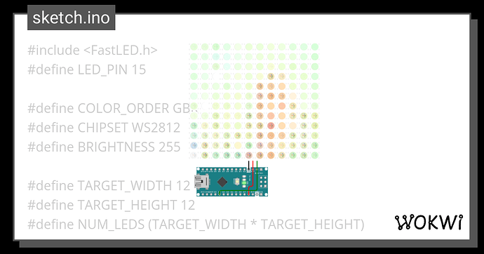

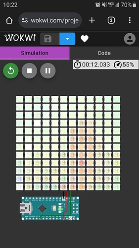

Here is my attempt at a 12x12 Neopixel representation of a 640x480 JPEG. The real neopix is worse.
