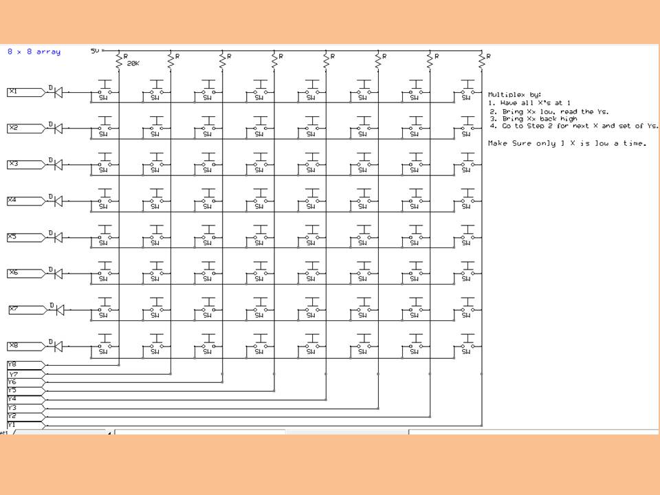

Hi... I'm a student, pretty new to Arduino. Trying to work on a project and was wondering about feasibility/best route to take.
I'm trying to build two grids, lets say 20x20, one of momentary buttons and one of LEDs, which correspond to each other (button at 0,0 on panel 1 lights up LED at 0,0 on panel 2). I'd like the two panels to be able to communicate wirelessly, and for the leds to remain on for a few seconds after the button is pressed and then turn off, so it's possible to write with your hand on the buttons and have it be readable on the other panel. I'm not sure what the best avenue is as far as getting all the buttons into one arduino and all the leds into another one, and have them able to communicate wirelessly (through Xbee or something). If anyone has any input, that would be great. If I'm missing information, please let me know. Thanks a lot.

Okay, the 74HC595 is output only, you need a different part for the shift it.
I wasn't thinking 20x20 array, but that's doable too.
For the LED array, I just posted an 8x8 matrix last night, search for "simple 8x8 matrix" you will arrange 3 shift registers to drive anodes, and 3 shift registers & high current drivers for the cathodes, and multiplex them. With all cathode drivers off, set up the anodes for row 1, turn the row 1 cathode driver on, then off. Set up anodes for row 2, turn row 2 cathode drive on, off.
Since 20 LEDs can need up to 400mA per row if you max brightness, a part like ULN2803
http://www.ti.com/product/uln2803a
is needed to sink all the current from the anodes.
Or a combination shift register/current driver like tcip6595
or 20 discrete transistors.

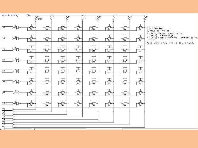

For the buttons,
You need to make a similar array. I have to think on this one a little to make sure I get the isolation between rows correct, so this might change.
Along one edge you will have 74HC595 with their outputs going thru a diode to one side of a button, button connected to the anode. All buttons in a row will have one side connected to the diode.
Down the column, the other side of the button will feed into a shift in register. Each column has a pullup resistor.
All rows will start high, with no buttons pressed the shift in register will read all 1s.
Take Row 1 diode cathode low, read the shift register. Any pressed buttons will read as 0. Do SPI transfer to read the 3 bytes in.
(might need ULN2803 as the current sink, depends on what you use for pullup resistors - 20K pullups should be okay with 74HC595)
Take Row 1 back, take the next row low, read again.
I'll draw this also, or a part of it anyway.
As discussed, expand out to 20x20 using shift registers.
thank you so much for the pictures. these are really helpful. So what you are saying is that I need two different types of shift registers
for the two panels? is that the parallel-in, serial out for the buttons, and serial in, parallel out (like the 74HC59) for the
LEDs? and then, for the LED side, I need to run all the anodes through the uln2803, which is just a chip containing 8 transistors. For the buttons, I need diodes between each pin of the 74HC59 and the switches, all of them have 20k resistors going to 5v. Dumb question: The X1, X2, X3, etc and the Y1, Y2, Y3 etc in the diagram are corresponding to the pins of different shift register chips? I'm a bit confused as to where the 3 shift registers for each side (anode/cathode) are used. The diagram makes it seem like only two chips are needed for each 8x8 matrix.
Sorry just trying to make absolutely certain before I begin to order parts.
Again, thank you so much.
I think you are getting the idea.
I only drew up 8x8 because it is hard to see more on a screen.
To go to 20 x 20 you just more of the same in each direction.
The X1, X2, ... Y1, Y2, ... are the inputs & output of the shift registers/ULN2803s, etc.
Yes, two chips for an 8x8. For a 20x20 (24x24) then three are needed on each side.
That switch matrix will work as long as only one or two buttons are pressed at a time. If you press 3 buttons such that two of them are in the same column and two are in the same row, then you will get a phantom fourth button press to complete the square.
I generally use one diode per push button, so that it works however many buttons are pressed. But that's a lot of diodes for a 20x20 matrix.
So you think a diode per button going to the X pins then?
Already have 40 buttons, wouldn't seem that big a deal to have 40 matching diodes. Especially if a PCB is made.
